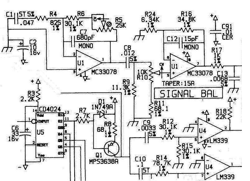

            See the tolerances of the used R and C components in a truly professional model. Why in the attached diagram of an amplifier are used very strange values of resistors? Why are such small tolerances? We can use in the circuit capacitors with a tolerance 10% instead of 5% because they are cheaper. We may use and cheaper resistors with tolerance 2% and even 5% instead of shown by designer 1%. If we make such an exchange of components, we can adjust with R5 and R10 the same parameters. However, the metal detector ceases to be a professional model. We can not guarantee that it will not increase noise and will not alter the phase characteristics after a few years (or after cyclic change in humidity and temperature).
              mikebg wrote: "Why are such small tolerances? We can use in the circuit capacitors with a tolerance 10% instead of 5% because they are cheaper. We may use and cheaper resistors with tolerance 2% and even 5% instead of shown by designer 1%. If we make such an exchange of components, we can adjust with R5 and R10 the same parameters. However, the metal detector ceases to be a professional model"
              I see a 1% resistor connected in series w/ a potentiometer R5.. That makes no sense to me, same story with R10 & R11.
