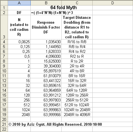

            The magic 64 fold myth
            Hi friends,
            it's really time to reveal the myth about this. The 64 fold applies only in the infinite distance to the coil (far distance region). In the near detection distance region (we usually have), the factor is less, which makes sense to increase the TX power.
            If we have a coil with radius R and double the target distance from distance N to 2N, where N is the multiple times of R (N related to coil radius R), then the exact diminish factor DF is:
            DF = ( (1+4*N²)/(1+N²) )³
            Example:
            If we have N=1, which means target distance doubling from R to 2R,
            then the target response diminish factor is DF = 15.625. So the target response is diminished by this factor DF. For this distance region, we have to increase the TX power by a factor of 15.625 to be able to detect the same target at double distance (2R).
            You will find for different distances the diminishing factors below in the table. Look, how fast the diminish factor convergates to the magic 64 fold.

                        Just an example:
                        We have a 20" mono-loop coil, coil R=10".
                        We can detect a small target at 5" (0.5R distance).
                        We now want to detect it at double distance (=10" or R distance).
                        The required TX power factor is according to the formula:
                        DF = 4.096
                        This is definitely not 64 fold! Only 4 fold.
                        Here is the big difference!
                        Aziz

                            Yes, I made the Biot-Savart Law proof.
                            But a lot of people are prospecting for tiny gold nuggets. They often detect it at the near distance region.
                            BTW, the distance R could be the near/far distance region limit.
                            According to the f(z) (see above), the a² and z² term should be focused. On z<a, only a² is dominating and on z>a, z² is dominating. Taking the distance R as the near/far distance limit is a good idea I think.
                            Aziz

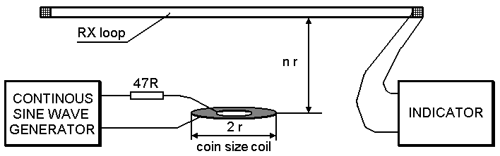

                              Instead simulation with software, you can make a target size coil and real experiments with it. Then you will understand that at small targets, the receiving path in practice appears in very far distance region. Most important is diameter of eddy current loop in target. Both important results mentioned above are valid for all sizes monocoils. Should be expressed what means term "gain". Even at zero GND signal, increasung ampereturns lead to increased AIR signal and you should reduce RX amplification to avoid its saturation. If RX sensitivity is limited by thermal noise, then increasing TX power will increase SNR. However at metal detecting AIR and GND signals limit the gain of preamp.
                              The attached image shows experiment of signal path from target to RX coil. To experiment signal path from TX coil to target, you should connect TX coil to sine generator and target size coil - to indicator.
