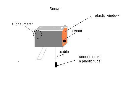

          Hi.
          I will try to draw it. Next time who i will see it i will take some photos.
          There are two sensors (no coils), one inside a plastic window and the other outside of the box conected through a cable.
            Sonar is closed to this shema...

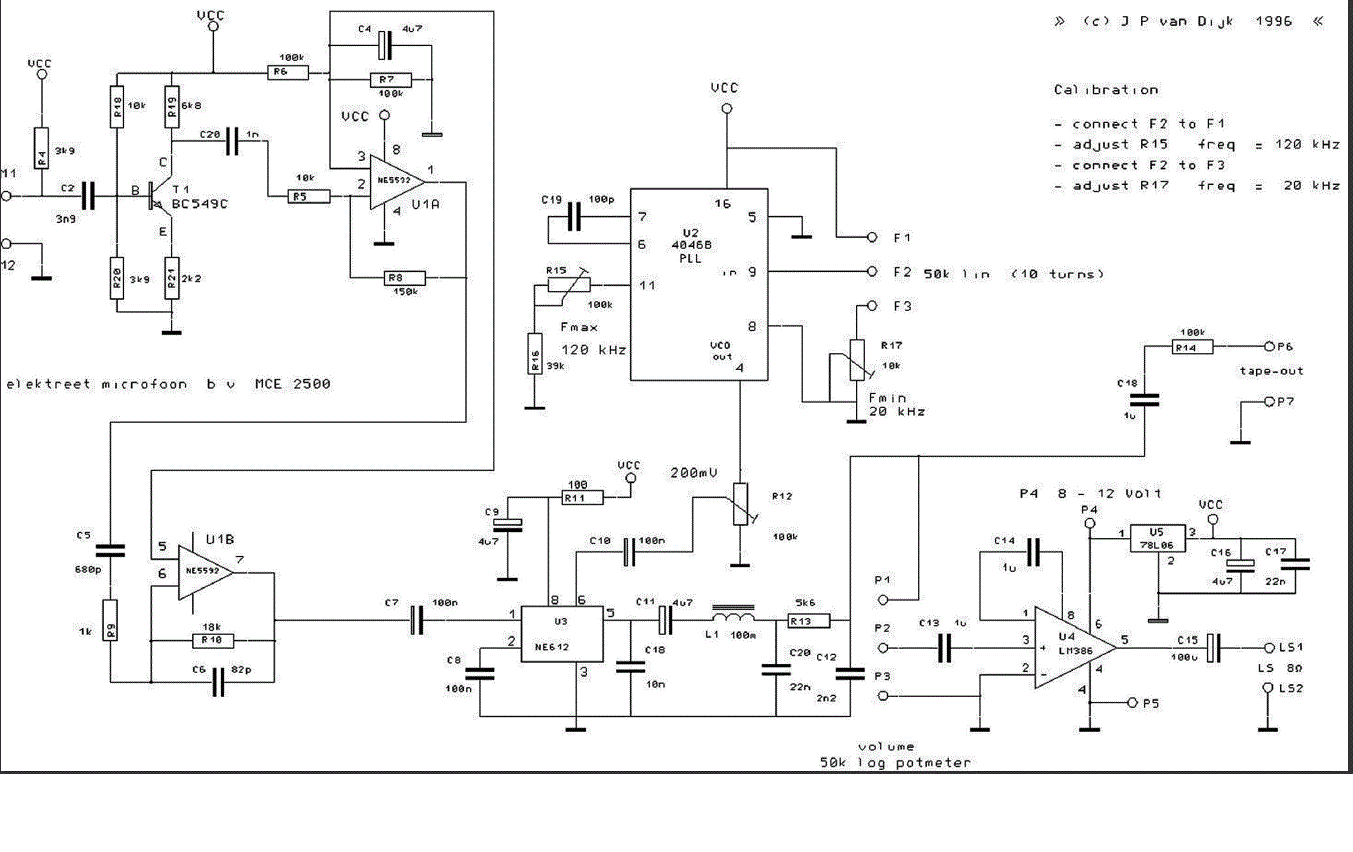

                            Hello Geo,
                            Found the schematic from the batdetector...
                            I never have seen an acoustics detector that can see so deep in the ground....I think a heavy power is needed for the energy that is needed to go so deep ??
                            Best regards.
                            Ap
                              Hi Geo.
                              A bit different translator today.
                              1. Notice, that the method of USG ( the transducer) it loses on crossing through two zones about large difference of thickness signal very a lot of.
                              Reflection on border of zones the wave.
                              Sonar in water has only one zone!
                              In medicine on USG gel patient be greased - one zone!
                              2. was this if would gradiometr type MI (magnetoinductive), (eg. FMG3) this also hard from far to measure from internal core the inductive field of small coil, 50kHz, working with current 1mA .
                              Write what weight of one sensor ( very light / light / heavy)?
                              What weight of gun - this depends from the power supply.
                              The battery of type 6F22 - 9V will not permit on work with large current! Battery 12V (0,5 kg and heavier) GPR suggests.
                              The Sensor in figure of coil from the ferite core length 5cm and the VLF more suggests the method.
                              You have choice now - what were Your feelings?
