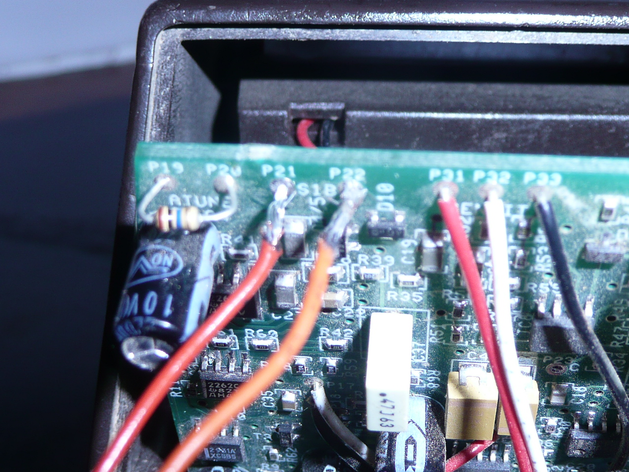

    Arrrrrrrrrrrrrrrrrrrrrrrrrrrrrrrrrrrrrrrrrrrrrrrrr ggggggggggggggggggggggggggghhhhhhhhhhh bought a second hand silver umax super cheap but im working on it since this morning but still got 2 probs:
    No audio in headphone socket is brand new and stereo..........headphones are versatile so i swap cable to get a mono or stereo answer nothing...................
    Pint point is not working push on off button is new but there again no luck........discri is ok power as well...................
    Help please!!!!!!!!!!!!!!!!!!!!

    Let's start from the beginning.
    Are you saying that the internal speaker is working but the headphones are not?
      Well the speaker is working fine as it should ,but it came with no headphones socket only 3 wires hanging...............bought a stereo socket this morning but still no luck.........

        Obviously then, this is just a wiring problem and should be easy to resolve.
        How about the rest of the detector. What works and what doesn't work?

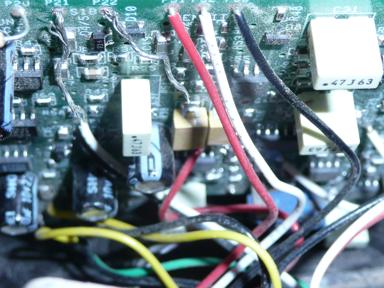

          Did replace pinpoint button but it was funny once the wire were connected no discrimination was on.................could pick up a nail................................so i solder them together t21 and t22 if i m correct and now i got discri but no pinpoint ...........which could be usefull for threshold setting got pics but camera batteries are charging..............maybe in 30 minutes or so
          Rivers Rat

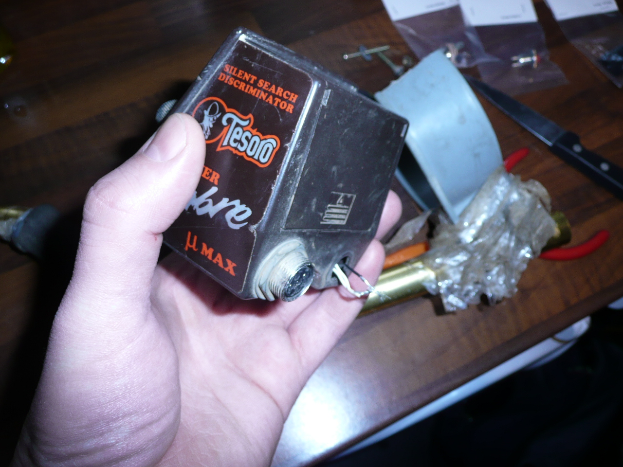

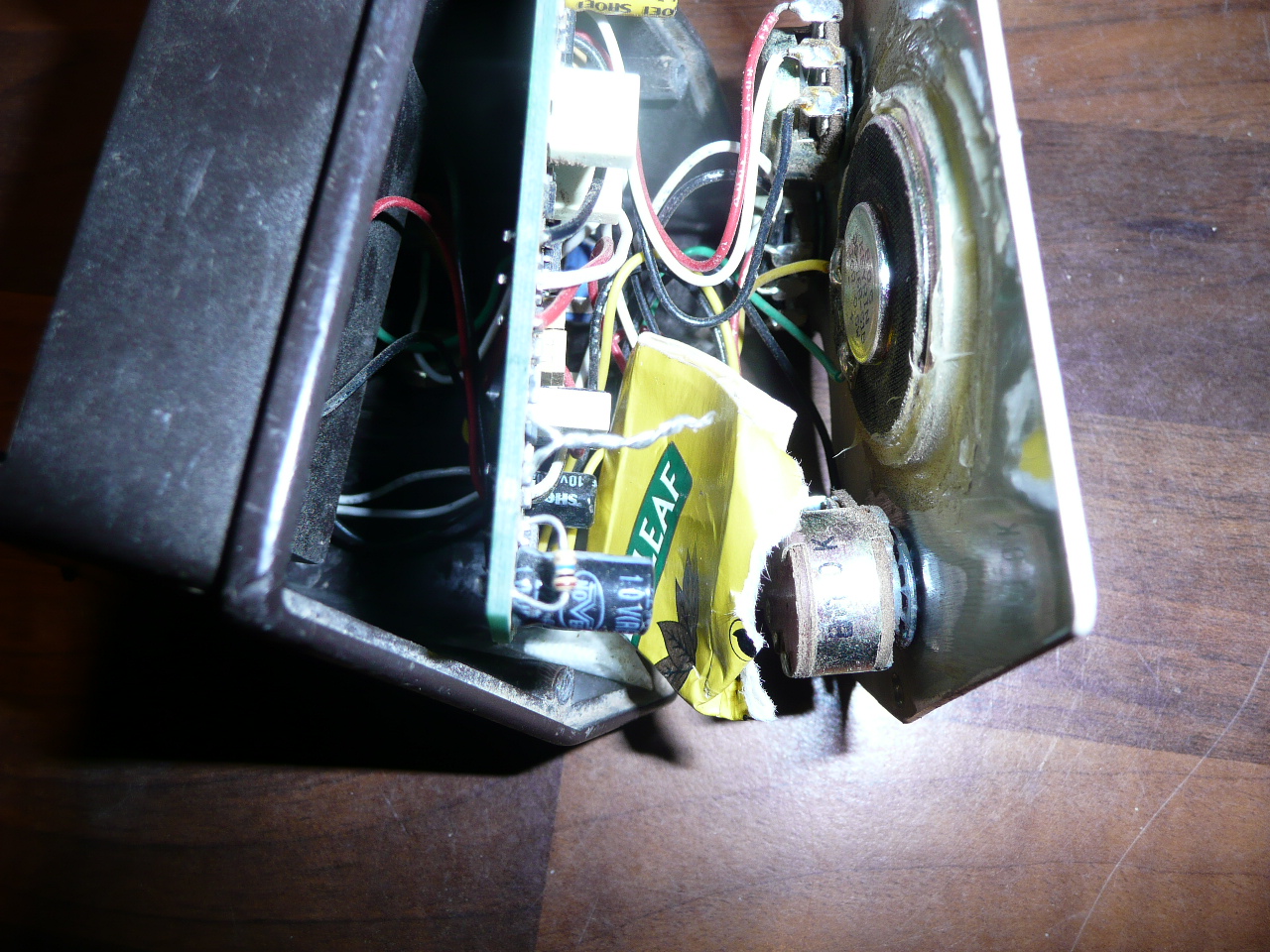

            Some pics
            Morning here are some pics of the beast......................pieces of cigarettes packet inside ............wasnt me.........need wires done by me on p21 and 22.....
            Many thanks for your future jelp
            Rivers rat

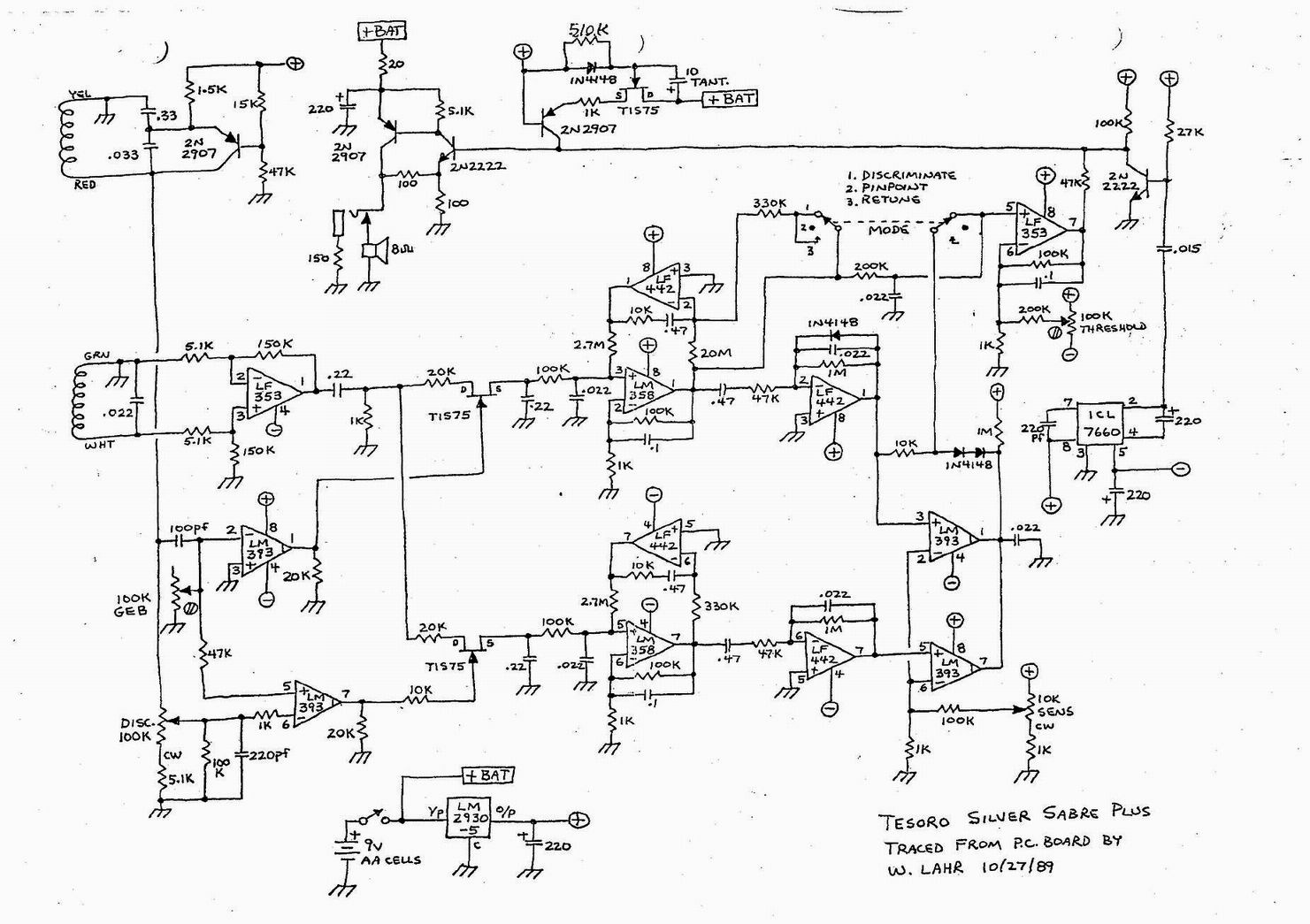

              Here's a schematic that could be useful. It's not the uMax version, but no doubt it is very similar.
                Thanks!!!!!!!!!!!!!!!!!!!!!!!!!!!!!!!!seems like greek to me but will try harder
                Rivers rat
