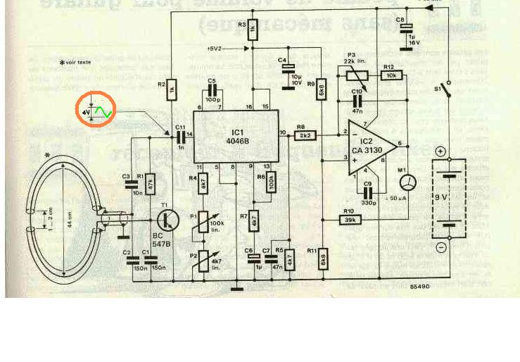

    Try this version. Can be usable as gold detector.

      That one Doesn't Work.
      The One Posted above by WM6 Does work.
      But I'm Not very impressed with the Sensitivity.
        dear WM6 , unfortunately your foto doesnt open to have a better look
        and as chemelec said what about increasing the sensitivity ?

          I will try better resolution.
          Sensitivity depends on how you build it , supply voltage, paired transistors, coil / but chemelec is right > this is not LRL.
            I made it before many years (25+) and it worked.

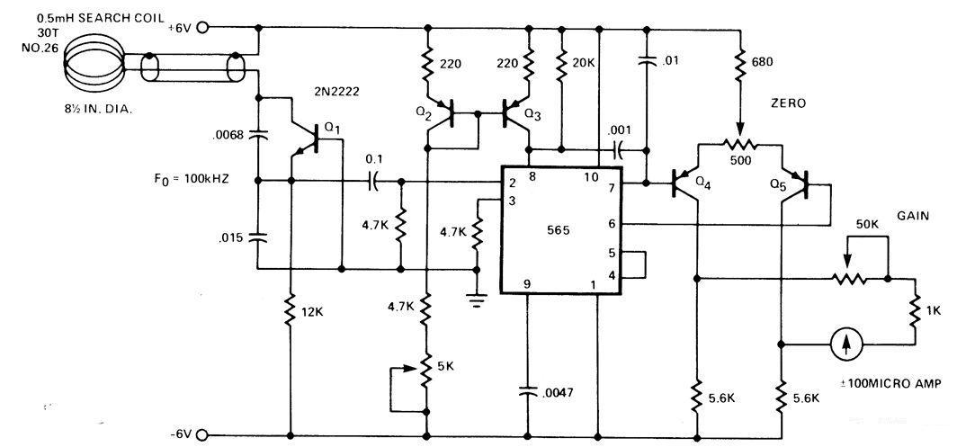

                I built this one,posted by Esteban,but cant put it to work...
                Its interesting becouse as only one single coil turn.
                  [ATTACH]13976[/ATTACH]
                  Hi morgan, did you check this (best by scope):

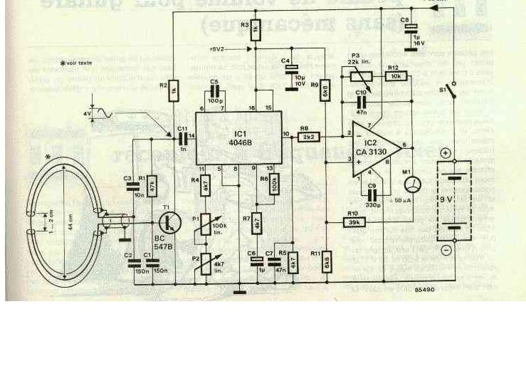

                    Hi.
                    About 20cm for a coin.
                    It is not something special, it is a BFO using a PLL, so it need a simple mono coil.
                        Thanks,i will try.
                          To Epitopios
                          Hi Pano. As i see the schematics, i had make the schematic that WM6 posted here. I am sure about this.
