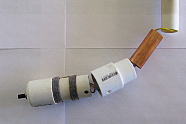

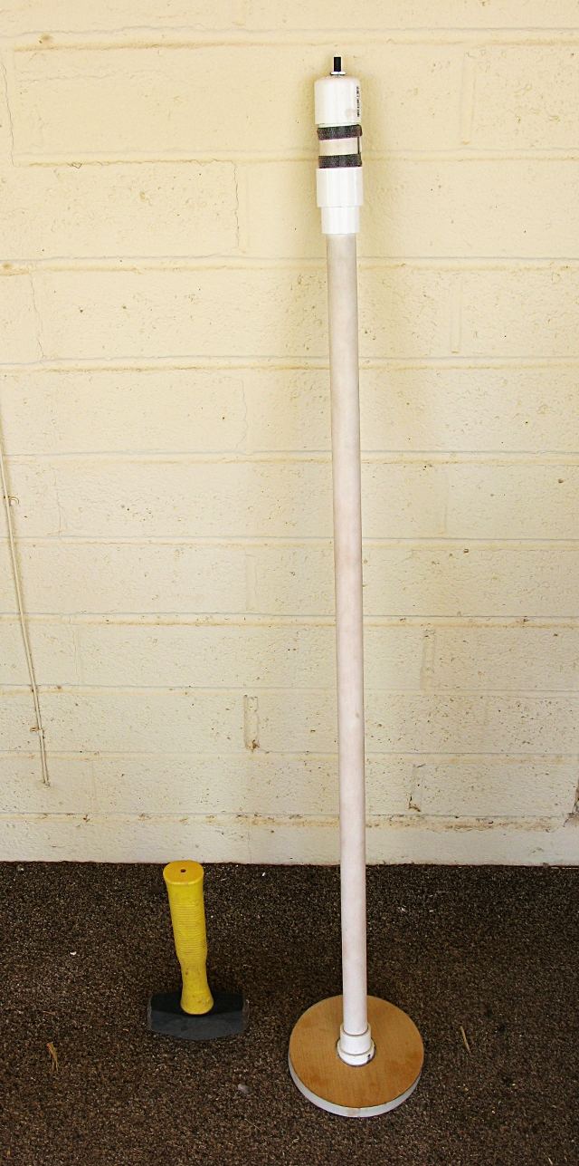

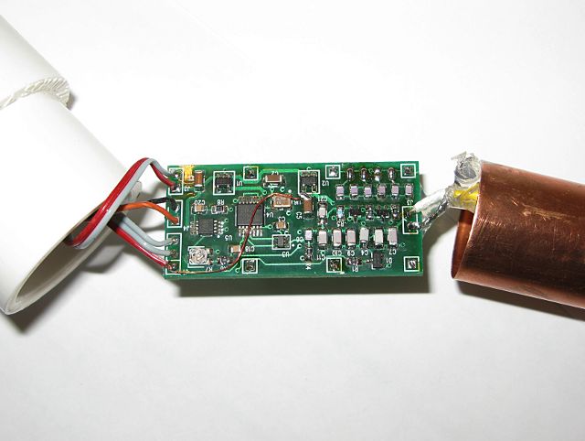

          I'm nearly finished with this one. It's based on the project 561 design and an similar one that I made. I'm just using it to find native copper in an open pit mine dump.
          I'll let you know how this rev 2 works in a week or two.
          I don't recommend trying to reproduce it unless you have experience with small SMD parts. Those varactor diodes are pretty hard to find, too.
          PJ
            Yes, BFO detectors are obsolete, but I had fun building this one. It does manage to find large chunks of copper, which is all I need at the moment.
            I had one PCB screwup - a trace was accidently deleted.
            The oscillator stability is pretty good. The drift is tolerable using a 16x reference frequency. Power consumption is low.
            I think 16x is probably about the practical upper limit for this scheme.
            With a shielded 150mm coil, in air, I can detect:
            penny at 4.5"
            beer can at 12"
            jeep at 20"
            PJ
