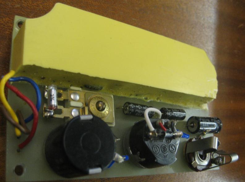

        I owned two of these and reverse engineered one of them at the cost of my health due to the noxious fumes trying to get the stuff off the components,
        there were a lot of polystyreen capacitors these melted in the heat used to remove the epoxy and the values were lost along with the transitor markings,
        the circuit was quite basic, I dont have a working schematic but am currently trying to reproduce it with modern parts, ive got the 4.5Khz 6" head osc up and running with 140turns of thin mag wire and still trying to re-develop the follower acoustic shaping circuits with decent gain to drive the mixer/outputs.

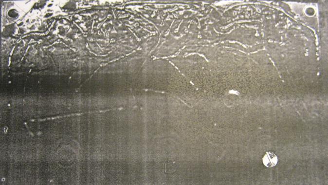

            I will try and get a piccy of the case aon here somehow as I still have the originag case and shaft + brochure but the PCB was no more after dissection and only have a dark photo copy of some tracks

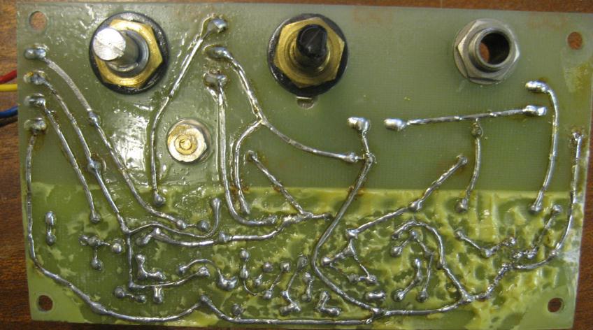

              Picture Test-1

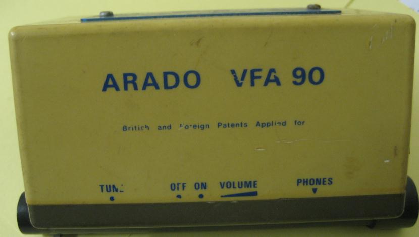

              Just Trying to see if I can send piccys in here of VFA 90 case etc.
                Piccys
                only rubbish photocopy of VFA 90 PCB Tracks i have
                dident have digi cams in those days :-)
                bottom left is headphone skt. middle = Vol/On-Off. far right = Multiturn 5k Tuning Pot made by (Spectral Reliance) hole above to right is pot core tuning.
                top left is audio out and mixing top right is search coil osc.

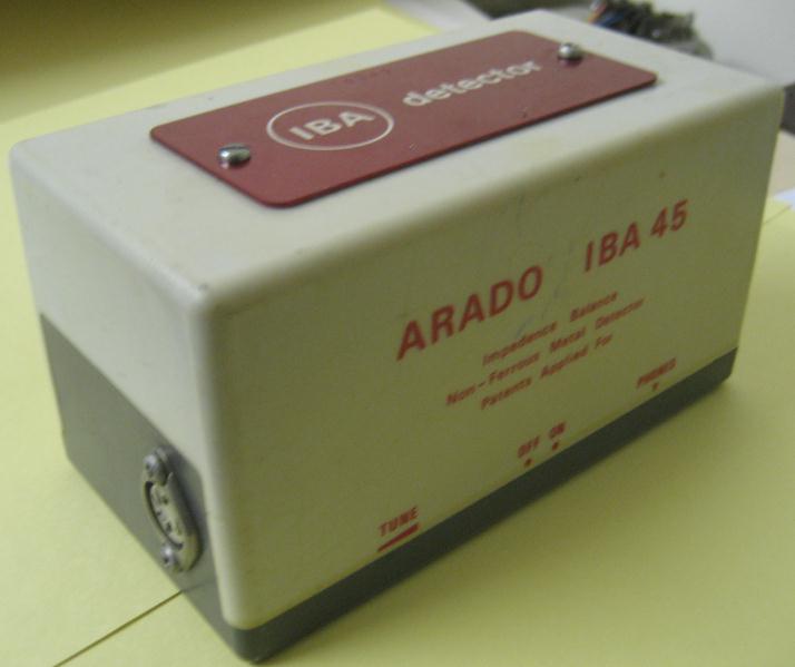

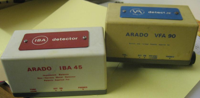

                  ARADO IBA45
                  in case anyone wants to compare things this is the views of same case used in both models and pcb construction with yellow potting as the VFA90 was, *** for ref the PCB is the IBA45 *** using with less components.
                  I am in the process of trying to repair my 45 as audio output has died and it took 3 hours to get 3 components out using a very hot soldering iron chiseling away to turn the compound to dust, the stink is still bad after 30 odd years :-)

                    It states on the case of both detectors "patent applied for", so I wonder if there is some record or other in the patents office files decribing these?

                            IBA 45 Schematic
                            I have the schematic hand drawn, but no scanner. If someone here can let me have a UK address I will post it this week. For putting on here.Its quite a simple circuit and I may be able to find rhe coil details.
                              IBA 45 Coil details
                              for a 7to 8 inch 2d coil Rx coil is 90 turns .35 wire. No tap. tuned with .033 cap
                              Rx coil is 90 turns .35 wire start then 37 then 8 CT then 8 then 37
                              So its 90 turns center tapped with 8 turns each side of center tap. Tuned with .033 cap
