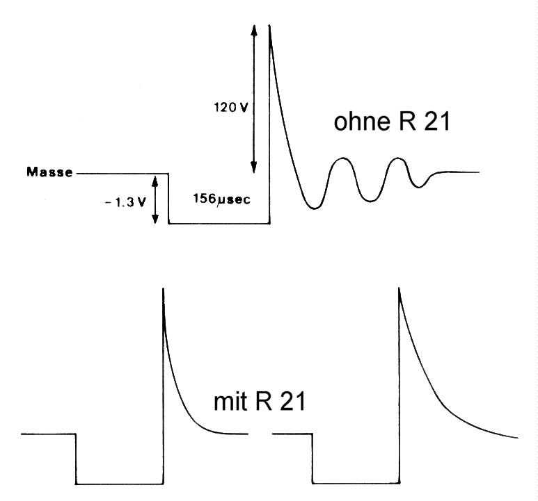

      Question resistance in parallel with the coil on the card do you it to change by the coil??

        the resistor value may be 680Ohm-1kOhm. on big STROBE DELAY Delta works off this is not playing so important role, as in beach hunting PI detectors with 5-15 usec of STROBE DELAY.
            for you if I well understood it may be 680 to 1 kW for large coil and less for small
            but how to calculate the value of this resistance for me??

              if Eric Foster does not know how to calculate... so what you want to hear from me??... look impulse form via your o-scope and try decrease the self resonanse addition.

                  How To Calculate The Damping Resistor
                  Here is the correct formula:
                  Rd = sqrt(L / (4*C) ),
                  where
                  Rd = damping resistor [Ohm]
                  L = inductance of the coil + coil lead [Henry]
                  C = total capacitance [Farad]
                  sqrt = square root
                  C is the sum of all capacitors (+parasitics):
                  - coils interwire capacitance
                  - coil shielding
                  - coil leads capacitance (+shielding)
                  - transmit circuits (mosfets) capacitance seen by the coil
                  - input capacitance of the front-end amplifier
                  Aziz

                    but contra experimentum nullum argumentum

                      You will find, that I have provided the standard unit of the parameters. You can multiply or divide with 10^x to convert it whatever you prefer.
                      Regarding the capacitor:
                      The formula is only valid for a low impedance path to the (parasitic) capacitor. The formula is describing the critical damping of the parallel circuit configuration of the damping resistor Rd, capacitor C and inductor L (Rd || L || C). If you have a high impedance path to the (parasitic) capacitor, the effective capacitance (it's contribution) will be low.
                      It's all a question of how much energy (E=0.5*C*U²) will be stored in the (parasitic) capacitor. If there is a high impedance path, there will be a high voltage drop at the impedance. Or think of it will reduce the current during the charge up time of the (parasitic) capacitor.
                      This is important to know, if you have a standard PI high voltage protection circuit via resistor and anti-parallel diodes. The input capacitance of the front-end amplifier is effectively less due to high impedance path. The anti-parallel diodes have also a capacitance, which will add to the input capacitance of the front-end amplifier.
                      The big portion of the parasitic capacitance comes from the transmitter mosfet (low impedance path, capacitance Cdg and Cds). It is usually blocked with an additional drain diode, which will lower the mosfets capacitance.
                      The most big portion of the parasitic capacitance comes from the coil shield, coil leads (shielding) and coil interwire capacitance.
                      Aziz
                        Hi all,
                        it seems, some of you are confused with the damping resistor calculations. You may not confuse the circuit topology. We will find different formulas. The most formulas were given for the serial RLC resonant circuit. So be careful.
                        But we have a parallel RLC resonant circuit here (we don't care the coils resistance here):
                        R = parallel damping resistor
                        L = coil
                        C = parallel parasitic capacitances
                        I have found a script (sorry, it's german), where you can follow the derivation of the formula: (see page 41 and 42)
                        d = 1/(2R)*sqrt(L/C), (grade of damping)
                        set d = 1 for critical damping (what we need)
                        1 = 1/(2R)*sqrt(L/C) | *R
                        R = 1/2 * sqrt(L/C) | we put 1/2 into the sqrt, sqrt(1/4)=1/2
                        R = sqrt( (1/4) * (L/C) )
                        R = sqrt( L / (4*C) ) (here we go)
                        Maybe it's simpler to use this:
                        R = 0.5* sqrt(L/C)
                        Aziz
