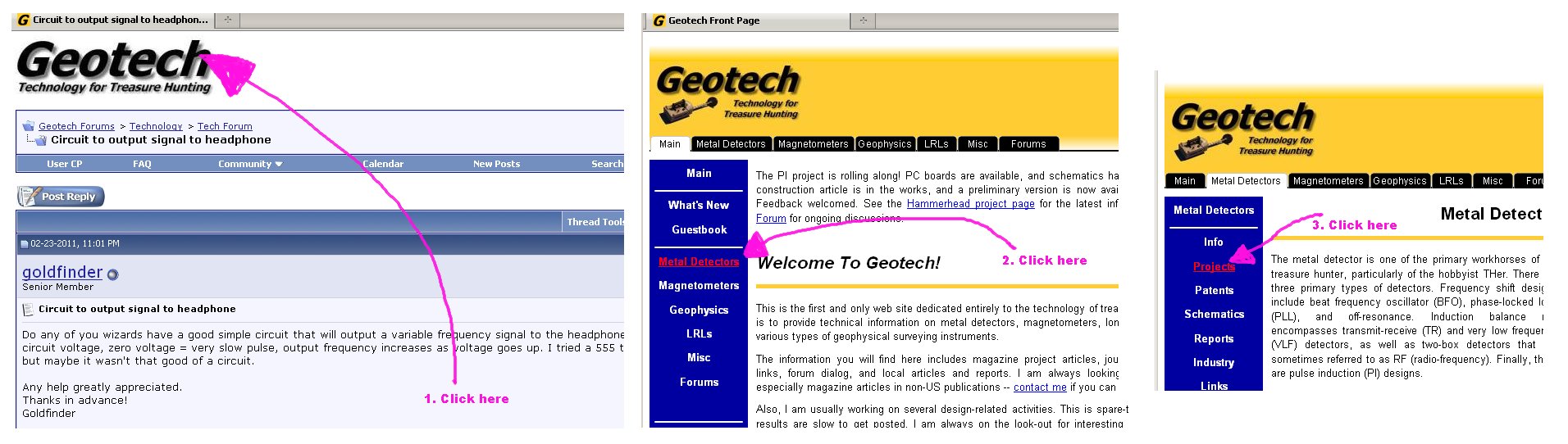

            Schematics - where
            Carl,
            I have a problem finding up to date schematics. With 100's of posts for a particular project it is very difficult to find a recent schematic and the associated PCB. Is there a specific place to get these?
            Goldfinder
              Originally posted by goldfinder View Post
              Carl,
              Goldfinder
              No, I'm not Carl. And you're right it is sometimes difficult to get easily digestible search results. It used to be easy but things got complicated and information got scattered.
              You'll find the Hammerhead about 2/3 down the third page.
              Also look for
                Found it - Thanks Porkluvr
                Thanks for directions.
                Found the 555 VCO.
                Goldfinder
