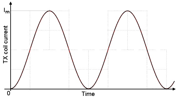

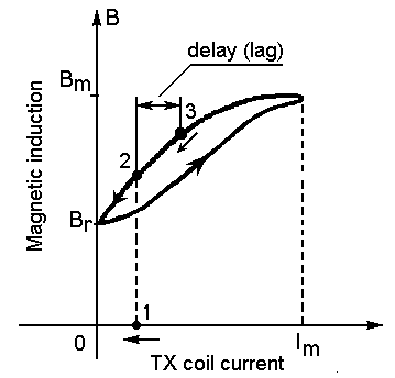

    Using time domain, I will make an explanation of magnetic viscosity in frequency domain. The figure below shows partial hysteresis cycle formed by classic Pulse induction - the coil current decays starting from value Im. In the figure is noted an instant value – the point 1 which moves fast in direction from Im to zero as shows the arrow. If there is no magnetic viscosity, the induction B of point 2 will correspond to current of point 1. When the substance has magnetic viscosity, the induction corresponds to point 3 because appears lag or delay of the response. The point 3 moves to value Br as shown with arrow when point 1 moves to zero. If point 1 moves faster, the delay or lag of point 3 increases.
    Now let we involve the conception for unidirectional sine induction and imagine that coil current oscillates between points Im and 0. We can make a real experiment because exsist function generators, which can add DC component to output wave. What happens when we increase frequency of oscillations? The point 1 moves faster and the lag of point 3 increases. In frequency domain that means the phase lag of induction B relative to excitation H increases.

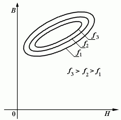

    However what happens with area of hysteresis loop when we increase frequency? I think it will decrease.
      Partial hysteresis cycles at increased frequency.

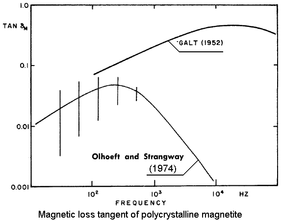

                Hi Tinkerer,
                Different authors measured different frequencies of maximal magnetic loss tangent for the same substance. Chart below is taken from paper
                "Magnetic Relaxation and the Electromagnetic Response Parameter" by G.R.Olhoeft and D.W.Strangway
                Note that the loss tangent of polycrystalline magnetite falls with 6 dB/oct after the maximum. I measured that at my artificial substance it falls with 3 dB/oct. The magnetic viscosity of my substance is far from reality.

                  Hi Mikebg,
                  now you really got me lost. Above you work with 1.73MHz and now you are down to very low frequencies again?

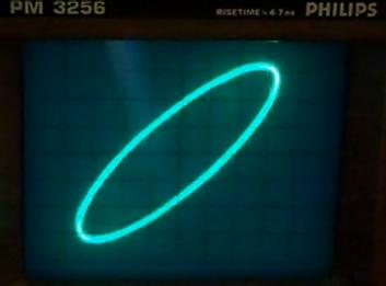

                    Magnetic viscosity and Lissajous oval
                    "A pure phase shift affects the eccentricity of the Lissajous oval. Analysis of the oval allows phase shift from an LTI system to be measured."
                    Source:
                    http://www.enotes.com/topic/Lissajous_curve
                    How this relates to bad ground with magnetic viscosity?
                    First, the ferromagnetic properties make the system nonlinear.
                    Second, the magnetic viscosity makes the system time variant.
                    Third, the Fourier transform is not applicable to a system that is not LTI system, so we can not talk about the phase shift.
                    However, look at the oval in posting #32 and the figure of Lissajous below. We can measure the diameters of the ellipse on the oscope and calculate the phase difference between TX current and the GND signal induced in the RX coil.

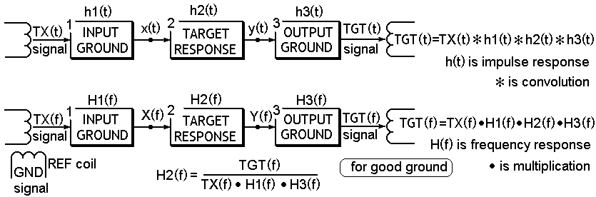

                              • #45
                                THE BLOCK DIAGRAM OF SENSING SYSTEM
                                Below are shown two block diagrams of the sensing system with target. The upper one is valid for all types sensyng sistems (linear, nonlinear, time invariant, time variable). The lower block diagram shows a LTI system which can be analyzed in frequency domain.
                                Description in time domain:
                                A time varying signal TX(t) excites with magnetic field the ground with target. We can make identification of target (block 2) if we know its impulse response h2(t). To calculate h2(t), we should know the input signal x(t) and the output signal y(t) of block 2 because we know that
                                y(t)=x(t)*h2(t)
                                where the sign * means convolution (свёртка) - an integral math operation (search the web for details). For calculation of h2(t) we should make deconvolution (обратная свёртка) - a complicated math operation.
                                At air test we know x(t) and y(t). The air test is specific case of measurement when h1(t)=1 and h3(t)=1.
                                The block diagram shows the common case (when the target is buried). Then the output of block 1 (input ground) excites the target (block 2) and output of target (signal y(t)) excites the block 3 (output ground). As result we receive a very convolved TGT signal from block 3. If we know only the TGT signal and TX signal, we can not calculate the deconvolution of h2(t).
                                Analyzis in frequency domain
                                (if the system is LTI)
                                A TX current containing suitable frequency spectrum excites with magnetic field the ground with target. We can make identification of target (block 2) if we know its frequency response H2(f). To calculate H2(f), we should know the input signal X(f) and the output signal Y(f) of block 2 because we know that
                                Y(f)=X(f).H2(f)
                                where the sign . (point) means multiplication. For calculation of H2(f) we should make division of two functions - a simple math operation:
                                H2(f)=Y(f)/X(f)
                                We know X(f) and Y(f) when we make air test. The air test is specific case of measurement when H1(f)=1 and H3(f)=1.
                                The block diagram shows the common case (when the target is buried). Then the output of block 1 excites the target (block 2) and output of target excites the block 3. As result we receive from block 3 a TGT(f) signal which is multiplication of several frequency responses. If we know the shape of frequency responses H1(f) and H3(f), we can calculate the shape of H2(f).
                                To know the shape of H1(f) and H3(f), we should receive a separate GND signal. A method for making this is illustraded in the lower left corner of the figure. A reference coil REF is positioned in induction balance to TX coil. Balance means AIR signal is zero, ie it receives only GND signal.
                                However if the ground has conductivity, H1(f) and H3(f) have different shape. We should make measurements to see if H1(f) and H3(f) differs in shape.
