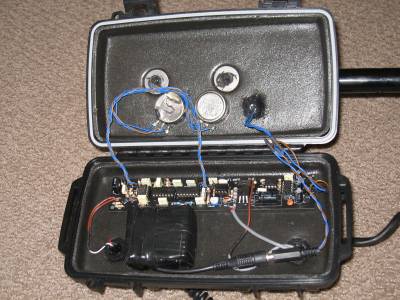

              I'll be finishing her up in a couple of days and hope to get out for a field test. I have the board in a small waterproof Otterbox with waterproofed pots and switches. Upon completion i will post some pics.

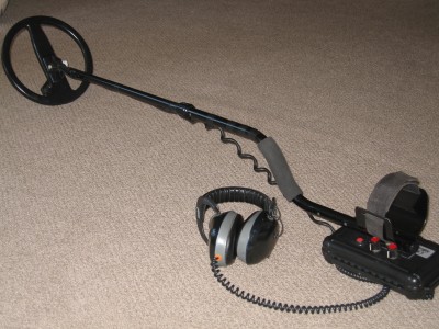

                      Here are a couple of pics....
