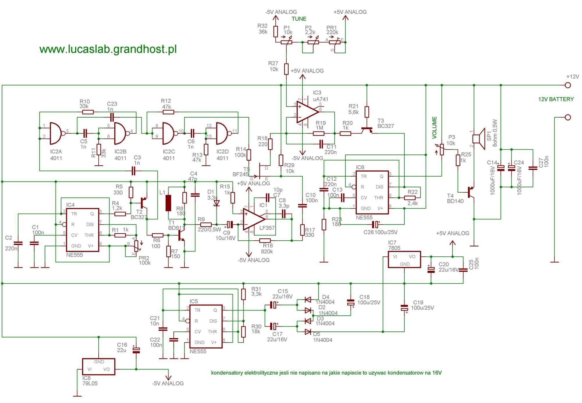

    very good ideea .. my first metal detector built on a test plate (pi poland) 16 cm coil turns 22 are to make improvements ..http://www.youtube.com/watch?v=4VBjCd-8_iI best regards..Cristi

        Hi, Cristi! Can you see the scheme of your detector (test on Video) G.L !
          schematic
          course my friend..in atache

                    Make the scheme above (POLAND PI), the video shows it works nice, stable.OK?
                    G.L!
                      i have the shematics already from mariusz (lucaslab)
                      have made the pcb some month before before it was shown on this forum
                      when it work so stable i should start to mount the components
                      the tiny was a older project from me i dont get to finish it last year - not enough time
                      the tiny works stable too but you have to run round 5 minutes some components get warm and that must be cant show it on video
                      but thank you i will start with lacaslab pi
