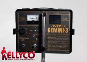

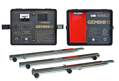

                    my counter question to you. you see here two Fishers. which is chinese crap one from those two? hoping you will call it right.

                        KT, both of those are Fisher units. The one on the left is the one I have, the one on the right has newer graphics.
