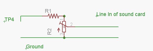

        Could you post the protection diagram? I don't want to damage my sound card...

              Be not afraid. The level of a signal should not exceed 0,5 volts. To reduce it you can using a simple RR divider. Besides you can reduce a level of a signal with the help of the control panel of a linear input (button of settings and button of windows volume control). In the electronics part of metal PI detector the maximal voltage can be about 5 volts. Means it is necessary to reduce it in 10 times or less. It is necessary to experementire. After measurement of signal level you can freely connect on an input of a sound card ( only linear input ).

                R divider for Line in
                " ...Could you post the protection diagram? I don't want to damage my sound card..."
                R1 50 K
                R2 5 K multiturn potentiometer
                  Hi cko47, thanks for the info and for the scheme
