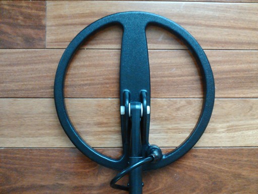

    just finished testing surf pi.
    i used the original schematic.tip32 ,using 7660 osc synced to the 555 .709
    opamp in front.i used a 9v pp3 100 maH.(all i have at minute)
    kitchen floor.
    thresh min
    delay fastest
    50p =10cm
    2p =9cm
    £1 = 8cm
    cufflink made from 2 solid silver sixpence = 5cm
    1940 half silver sixpence = 6cm
    5p =5cm
    gold earing and a st christopher and chain approx 1gram total.= 0cm
    I didn't get great results with a 9v pp3 - 8 x AA works much better

      23cm diameter coil, 20 turns made with 0.5mm (24 gauge).

          thanks Don for that info.wow i like that deeper in the ground results part.what going on there then.i shall be making a test plot in the garden soon something similar to yours.nice idea with the pole to bury the targets.
