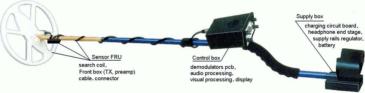

                  METAL DETECTOR COMPOSED OF FRU?
                  Metal detector composed of FuRUs
                  FRU means "Field Replaceable Unit":
                  "A Field Replaceable Unit or FRU is a circuit board, part or assembly that can be quickly and easily removed from a personal computer or other piece of electronic equipment, and replaced by the user or a technician without having to send the entire product or system to a repair facility. FRUs allow a technician lacking in-depth product knowledge to fault isolate and replace faulty components." This explanation is given in
                  For example, the sensing head (search coil) of a metal detector appears as a FRU when it is connected by a connector or with screw terminals.
                  However we can replace a sensing head in the field not only because it is faulty. Often we need other model sensing head more sensitive to wanted targets or more suitable for different soil conditions.
                  Let we change the abbreviation FRU with FuRU having description "Functional Replaceable Unit".
                  For easy future improvements of a project, we can design the metal detector composed of functional replaceable units. We should avoid motherboard and lot of connectors for our design because they reduce reliability and need more place. Unlike sensing head, replaceable in the field, we will replace our FuRUs in home using soldering iron. This is not dificult because FuRUs for metal detector have only several leads.
                  Attached figure illustrates an idea of FuRU designed metal detector for aesy improvements and upgrading. Note that search head with its front end box and cables form a real FRU because has connector (can be replaced in the field). All other modules are not FRU if they need soldering iron for replacing.
