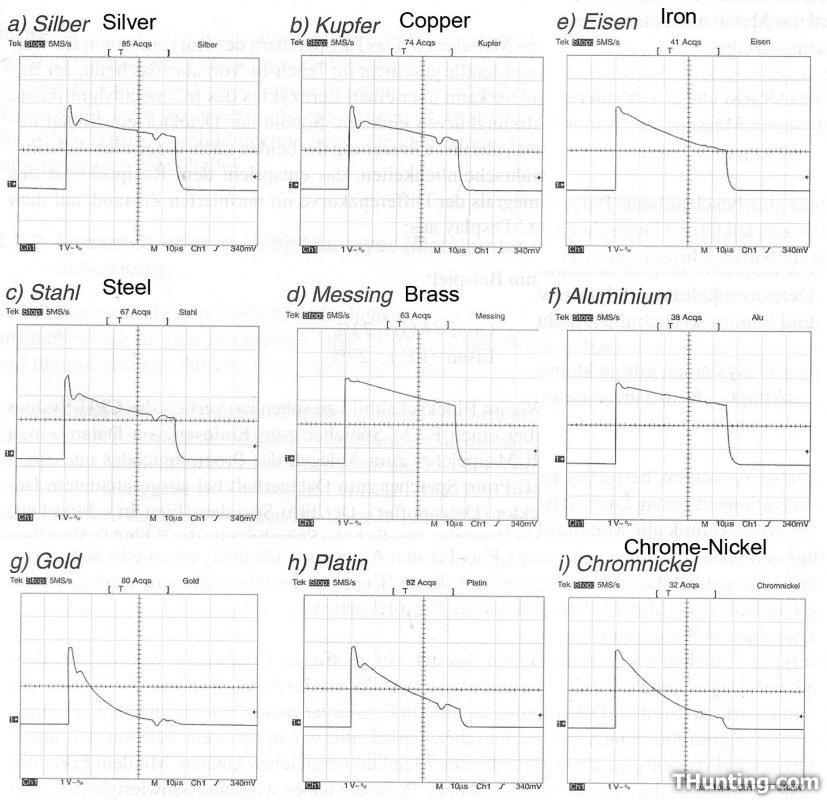

            Here's some more things to think about!
            Got this off here someplace.
                  This is a very good experiment, but it needs to be repeated with targets of exactly the same size and shape.
                  Then it needs to be repeated with different, but equal shapes.
                  For example, take 10mm diameter spheres each of the metals described above and run the test series.
                  Then take 20mm diameter disks of the same metals and run the test series.
                  Then take the same disks and run the series with the disks at 45 degrees and 90 degrees.
                  Then take a black sand test bes and repeat all the tests above.
                  Then make a salt test bed and repeat.
                  Then mix a salt and black sand test bed and repeat.
                  Then compute all the results and see if you can detect a common denominator.
                  There is a lot that can be done but it is a lot of work.
                  Only with a lot of work you will break through the "PI discrimination wall"
                  Good luck.
                  Tinkerer

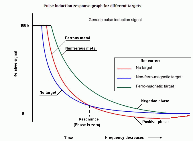

                    Below are given frequency responses of different targets in complex plane. At single frequency metal detectors, the response is represented only by one point in complex plane.

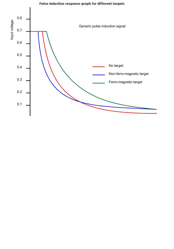

                      In general speaking in ferous objects frequency increeses and vice versa. I am just trying to find a way to discriminate between ferous and not with a pi md only cause they have more depth ability. Thank you.
                        I think the color legend given in posting #3 is not correct. According signals in complex plane (posting #10), the color legend should seem so:
                          Lovely graph, but this will never happen in real world. We are talking about monocoil PI, not to stretch discussion further. Under normal conditions, coils and normal targets, all we can have from coil output is superposition of coil signal (remember that you always have a lump of metal in search coil, well, coil itself) and that from target eddy current decay. And it will never going negative as shown in this graph, no matter target is Fe or non-Fe. So there is no "magic" sampling point that can "discriminate" between materials of different magnetic properties. Only decay rate will depend upon target shape, size and material (conductivity), being fast for small and conductive, and longer for large targets.
