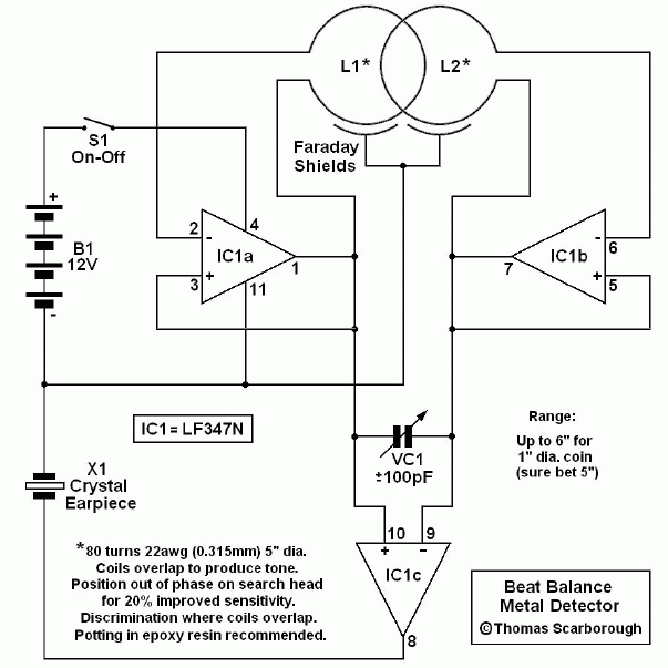

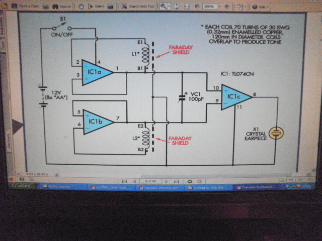

Hi can one of you tech guys help me on this simple self build one.
the detector tunes with a 100pf varable capacitor, but i like to replace with a pot.
it runs at 10khz approx.
I wanted to attach my circuit on here but i see no provision , anyway any tips would be handy
Many thanks
Dave
