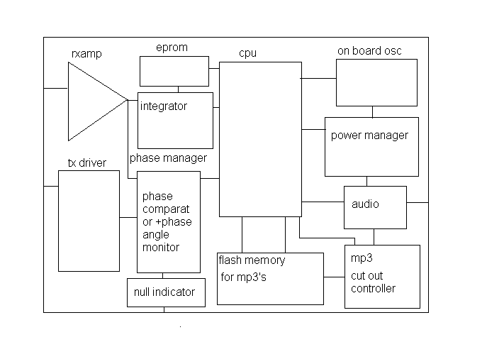

          What is your block diagram?

          Taliesin, I will realise if you show me the block diagram of your ultimate metal detector
            this is the basic outline mine
            there's lots of work to do yet mike .like song choices and stuff
