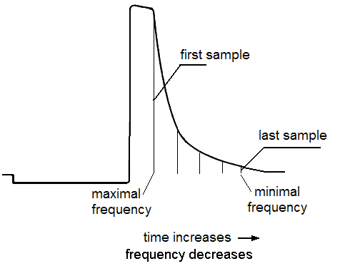

    Dave, at pulse induction each sample corresponds to a frequency. When sample delay increases, the frequency of sample decreases as shown below.
    When we use for signal processing only one short sample, our PI operates as narrow band (CW or single frequency) metal detector. The drawback of this VLF metal detector is that TX is very inefficient, but we can easy change its operating frequency.
    When we use for signal processing more samples, the PI operates as wide band metal detector. The maximal possible frequency is illustraded below.
      Dave is not asking about pulse induction. He is asking about Minelab's FBS system ->
