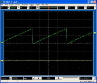

    According Monolith, "Shielding the coil, this phenomena is attenuated or eliminated. In fact, I use it to test the shielding. If the detector does not detect the hand anymore, the shield is good enough."
    According Charles Garrett, the shielding eliminates the "Green grass signal".
    I think, the shielding can not suppress conductive signals because they are generated by eddy currents in substances shown below.
    We can assume that the target response from the hand is caused by the body conductivity. The TX with the conductivity generates eddy currents.
    But hen I tried an LRL rod, and hooked it (myself) up to the FFT, I got a very wide spectrum.
    A similar spectrum like from the RX coil without the TX on. The RX coil's self resonance distorted the response somewhat.
    That leaves us with more questions than answers.

            Thanks for the links. Some interesting comments, but I prefer to avoid the mystical and stay with stuff that I can measure and reproduce.
            Since I mentioned a LRL first myself, I better explain that.
            When I first encountered the noise problem when using less than 10us delay with a PI,
            I first looked at the signal spectrum that the coil captures, when it is used as an antenna. Above the coil's self resonating frequency the amplitude of the signal diminished, but the spectrum went way beyond.
            Then I looked at the influence of my hands.
            Then I thought, if my hands do that, what would an extension of the hand do? so I bent a 3.18mm aluminum TIG welding rod at right angle and held it in the hand like a LRL and looked at the signal spectrum. I posted the screen picture of that on the forum, but this is many years ago, I don't remember the thread or post.
            Then I started to try many different shielding methods, until I found that simple verification of the shielding quality.
            A long road that lead me to two simple rules that kept me happy until now.
            The shield should not be detected by the detector.
            The hand should not be detected by the shielded coil.
            Nothing mystical.
            But now I would like to know more about the mechanism of radiation or transmission from the body to wires or antennas or coils or RX boards.
            What is happening?
            Why is it happening?
            How can I control what is happening!
            Did I hear the word control freak?

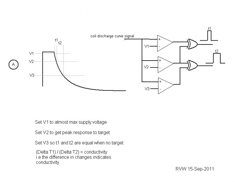

                I have been working on discrimination (Between different targets not iron discrimination) on this PI.
                I think I am happy with the attached circuit .
                The attached simple circuit can be used to tell the difference between targets:
                Example:
                5c, copper coin, bottle cap, 20c
                Try it.
                The more resistive a target, the more 'peaky' the signal.
                Slower (conductive) targets decay slower.

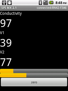

                    I now have an Android interface to the detector.
                    The phone is a Huwaei Ideos ($60), running android 2.1
                    I talk to it using a bluetooth interface (RN-42), these appear as a serial interface (uart) to your micro. (Less than $20).
                    So, the Metal detector is connected to the phone via a 114200 bps UART (with all the bluetooth stuff magically taken care of).
                    Now I can see the following on my phone (see screen shot): Signal level1, Signal level 2 and conductivity.
                    The two signal levels are the levels at two different sample delays, the conductivity is the ratio between them.
                    I hope to test it soon in the field. and give results..

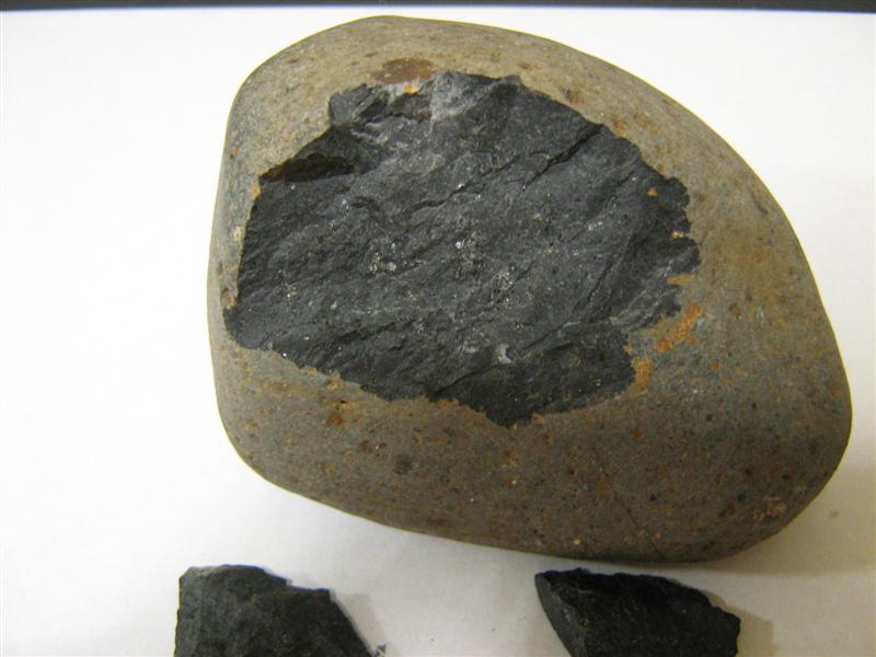

                    I tried it at a creek, and found some nails and a magnetic rock (pic attached)...perhaps someone can tell me what it is ?,..it isn't an asteroid apparently. ?

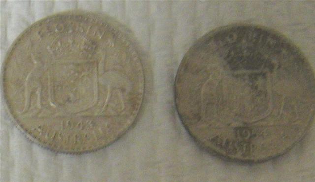

                        I have attached some results of detecting around a tree in an old park.
                        I'm sure lots of people have sat there over the last 80 years, and it seems every single one of them had a can of soft drink and threw away the pulltab.
                        I found 2 Florins ! (Pre-decimal Australin coins).
                        I have half of that tree left to go,... and 50 more trees in that park.
                        THe coin with >90% silver has a lower conductivity than the one with 50% silver,..this seems strange, but the metal detector doesn't lie !, so the alloy of 50% silver must have higher conductivity... though I haven't found any info to confirm that..
