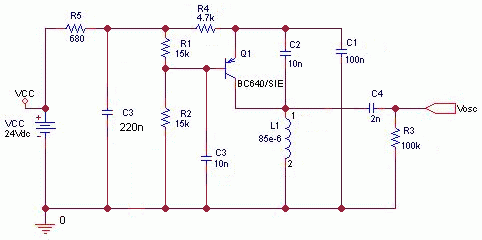

    Hi everybody,
    I been surfing the web and my electronics books for a long time searching for an answer. I already posted this question 2 years before, but nobody wrote a "full" answer.
    The question is how to determinate the caps values in a common-base colpitts oscillator. I mean, the coil value is fixed because is difficult to vary, and so I had to choose the caps. I know that total C is calculated with
    w osc =1/sqr (LC)
    C=C1C2/(C1+C2)
    Ok, perfect but what is the criterion to choose C1 and C2??
    I have an Colpitts oscillator running and if I vary one of the caps (10 nF to 100nF) the signal becomes unstable. Also, with another coils the signal stability got worse.
    I guess that is something about the quality factor (the higher, the better) if you know how to improve it ¡¡iplease tell me!!
    Thanks in advance

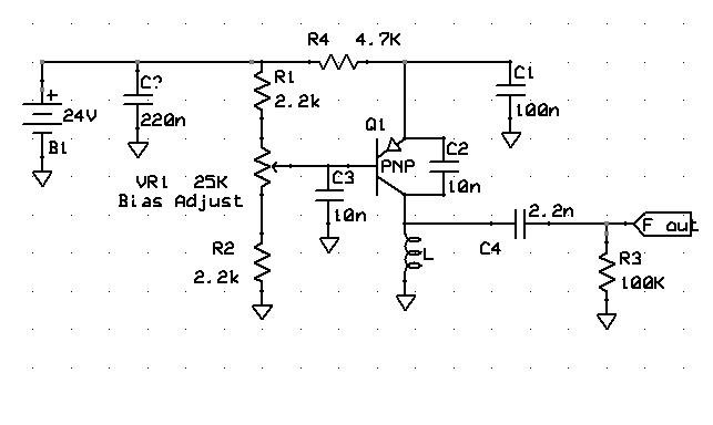

    Here is the correct drawing of your oscillator circuit. Note that C3 is not part of tank circuit, that's why C1 is connected direct to GND. For amplitude adjustment, you should decrease resistance of R4 until amplitude stops to increase (for example 22V), and then slight increase resistance (for amplitude 21V).
      I know that C3 is not part of the tank I guess that is for filtering the base polarization voltage.
      For the same oscillation frequency I can use a big coil with small caps, big caps and small coil and medium sizes of both. That´s only an example, but represents the problem. I tried to change C2 to 100 nF and the result was a change in the oscillation frequency (as expected) and a "funny party" of noise in amplitude and frequency (above all in frequency). I saw another metal detector like this one and there was a 5.6 nF cap in parallel with the 10 nF one, so there is some kind of cap adjustment.

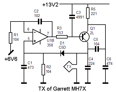

        Here is an ancient oscillator circuit with P-I controller designed by Robert Podhrasky (Garrett Electronics). You should increase capacitance of integrating capacitor in order to prolong settling time. I will seek for more new variant of this design.
          Ok, but do you think that the oscillator design is better than the one I posted?

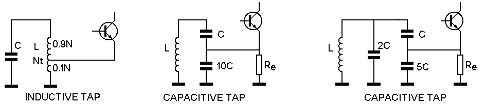

                        Mark, you are correct. The emitter of transistor creates problem because represents a load for tank circuit and diminishes its Q-factor. The problem is solved by using a tap in tank circuit to maintain its operating Q-factor enough high. In the last oscillator circuits of Garrett, the tap is formed by three capacitors as shown in the right circuit diagram.
                          I´d like to test both circuits, the Capacitive Tap by Mikebg and the one by Altra.
                          I suppose that the collector pin of the BJT is connected to the coil and C common point isn´t it? Also, the base pin is polarized like in the typical colpitts circuits.
                          If I´m wrong please tell me.
                          Thanks a lot.
