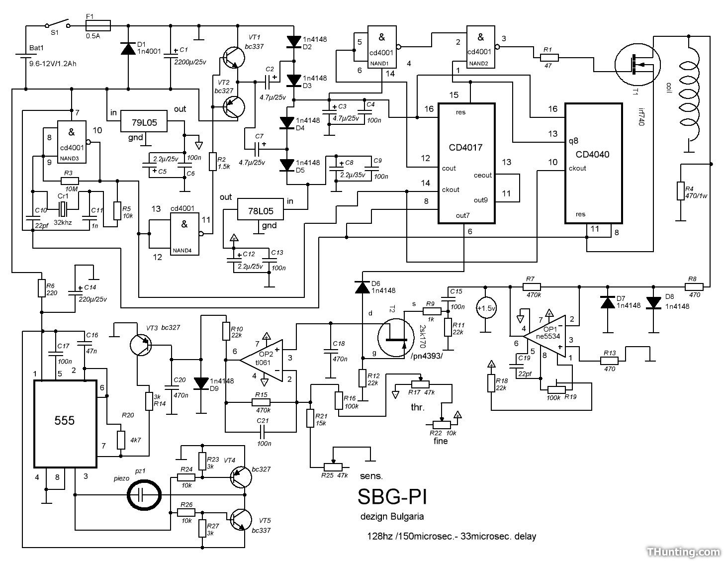

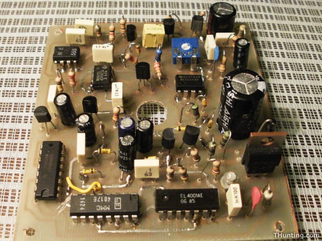

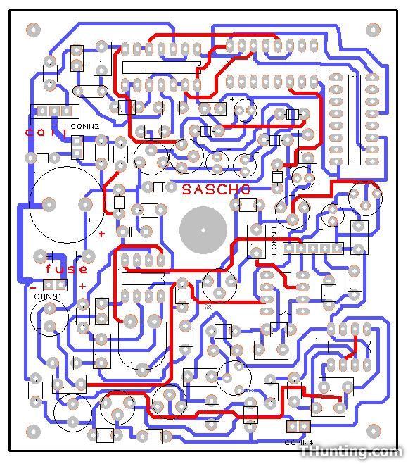

    Here it is a new project from Sascho BG. Coil 150mm, 1mm wire, winding 24. Detection coil with 150mm for 20mm coin at a distance of 24cm.

    A question for C3, C4 :
    In schematic is Gnd and on PCB is -V ?

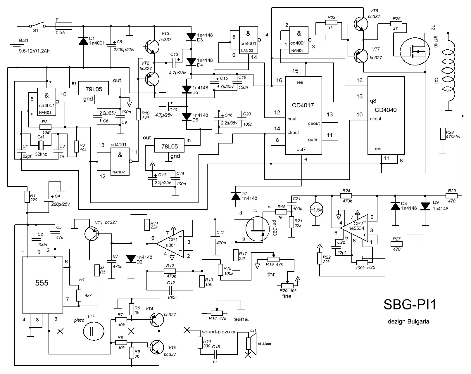

        SBG-PI mod.Work better.Click image for larger version
          I really like that sample and hold circuit on R18-T1-C17
          To get 1000x gain for preamp you can see 470 Ohm / 470K here and it is better than 1K / 1M you can see in most PI detectors.
          Top part of the schematic asking to be replaced with one 8 pin PIC or Attiny
            In theory and kite can fly, but people make airplane.Make something working and I boast you.
              With smaller resistors amplifier is fast and stable. Because of input current must be respected R29=R27./In operational amplifiers with bipolar transistor input theory./
