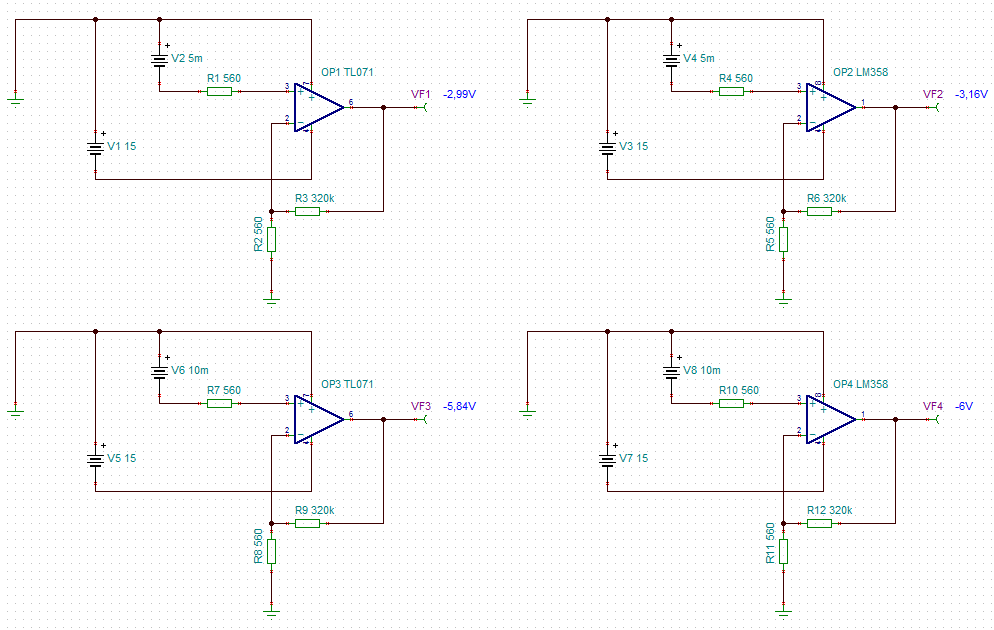

      TL071 will run on single supply
      • Now i understand you)
        I checked tl071 in tinaTI and see no difference except that we need to try a new board layout.

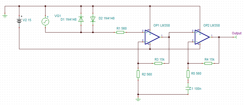

        • Also we can use unused part of lm358 (or tl072), split amplifier into two stage with gain X28, and add high-pass filter with 100Hz cut off. Otput must be without any capacitors, becouse ADC has some input bias currents.
          And If i not make mistakes, total gain wil be around 770.
          How do you think about my idea?
              ps: i may be wrong)
              [ATTACH]48320[/ATTACH]
              Thanks, interesting idea.
