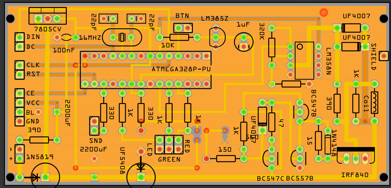

    • gnd improvements
      displacement components
      displacement tracks
      removed unnecessary capacitors
      added power input diode 1N5819
      wires size correction
      this is truly the last: P

        • reduced pcb
          small improvements

            • V0.8
              correct capacitor dimensions
              fixed an lcd connection
              improved component positioning
              as soon as the material arrives I produce this version
              • these days I have designed a single layer version ready and finished.
                In the zip there is all that is necessary.
                Read the readme!

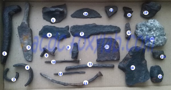

                    • Finds in our garden with FoxyPI (after electrolytic cleaning):
                      • Hiya Useus,,,,Thanks for the files. Is there a Sprint layout for the pcb please? I'm having trouble opening the Gerber files in Sprin layout 6. Thanks, Marty.
                        • Hiya Useus,,,,Ignore my last post,,,I managed to open the file now,,,Thanks, Marty.
                          • Originally posted by FoxyLab View Post
                            N1 - old railroad nail (старий залізничний костиль)
                            • Hi Marty, better you import the PCB layout as picture in the backgraund from SprintLayout and then redraw all parts, copper tracks and GND plane
                              result is better than gerber import, also you get a clean BOM List im you fit every part with clean part number and value
                              i would do it this way but have no time the next days
                              • Originally posted by Vadim18 View Post
                                There, many objects are of interest to me - a forged handle (5), a strange forged cone with a thread on the base (9), a circle segment (14), the remains of a knife (?) (6,7), an element of an agricultural implement (?) (2) , a massive piece ( 18 ) , similar to a fragment of a shell / mine / bomb, but with artificial recesses inside ...
