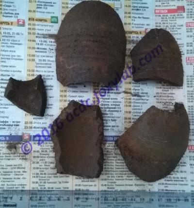

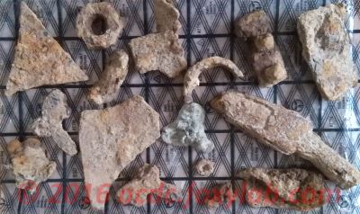

                            My new finds:
                            Guess what it is?
                            • #44
                              Some sort of cannon projectile ?
                              • #45
                                Yes, fragments of mortar shell (IMHO german 81,4 mm).
