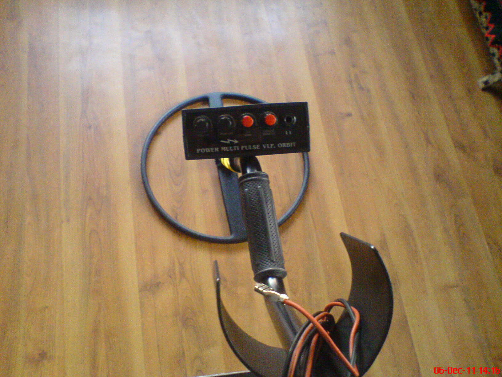

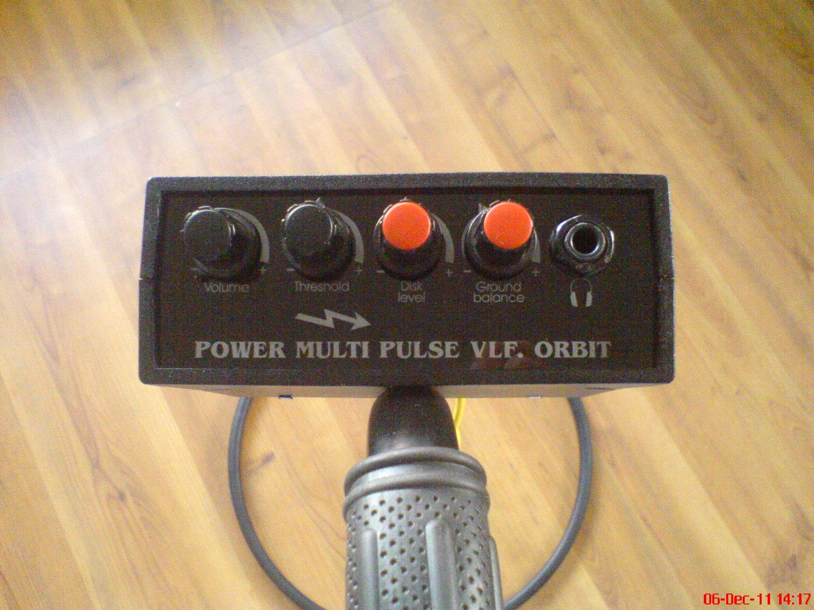

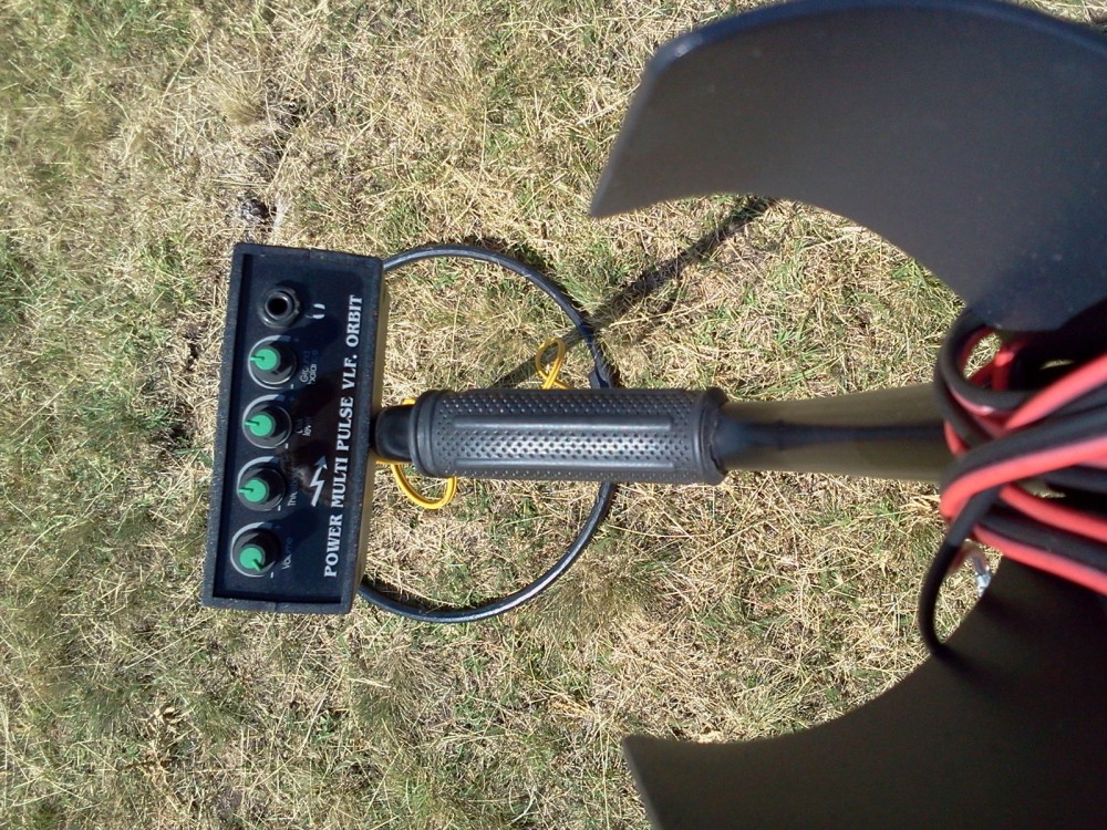

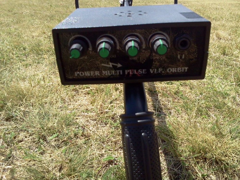

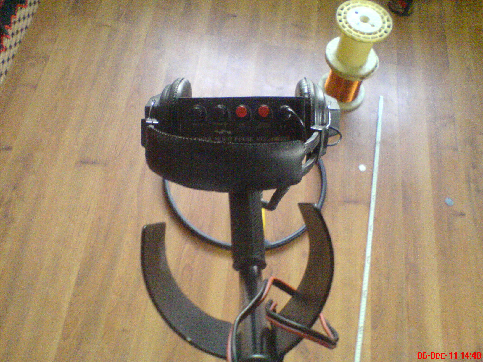

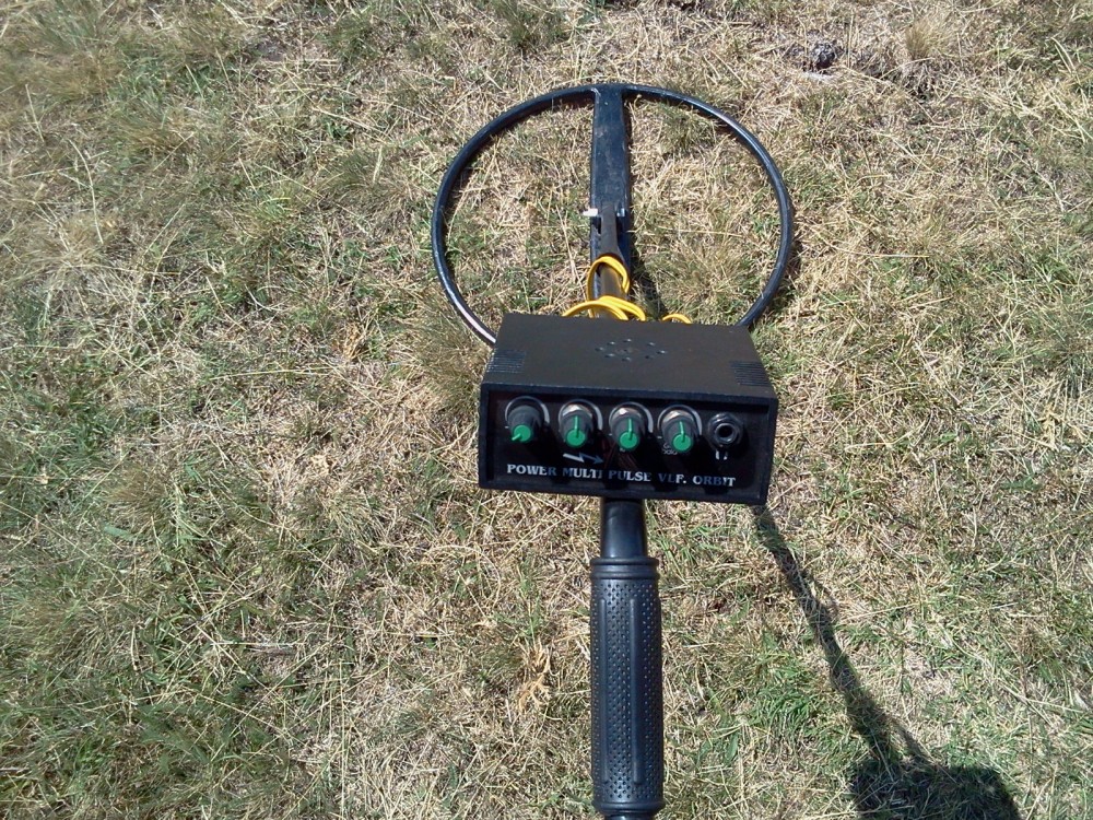

I am a trumpet, but I make the metal detectors that work fantastically .This is already used by more than half a year and people say it works just fine. working frequency, 4.3 kHz audio frequency 600Hz,command, on of, sets the tone, trshold, hand balance of the country, setting the level of discrimination,Command discrimination by a dual-tone discrimination ,iron objects, or ignored, or in two-tone mode gives an acoustic indication of the iron and 300Hz at the precious metals 600 hz.
