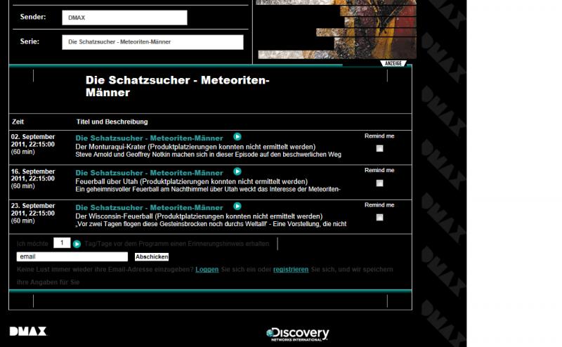

                    Hi!
                    Cool, you saw exactly the same. Since 3 months every friday at 10pm D-MAX (TV for man @ 19° east Astra sat) shows something about treasure hunters.
                    btw. I also read the report about meteorites in the "handbook for detectorusers" of Gert Gesink from the netherlands. I'm shure you know it.
                    Only 8 turns?? Such few windings already will work? Hard to believe. The 1m Jeohunter coil weights around 10kg and for shure has hundred of windings of very thin wire. Neverthless very interesting and a great weight reducement if working with selfbuilt very large coil.
