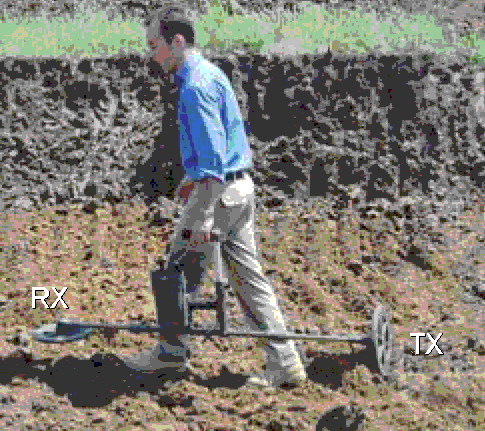

    i want to make metal detector can detect iron (size about 1m*1m) on depth 2 or 3 meter (greatest depths)
    plzzz can someone help
    my best regards
    You probably either need to build two-box detector, or else PI detector with VERY large coil, large enough that you need to have it mounted on wheels.
    You can use SEARCH button and do some research on "Two-Box" and "Deltapulse" (also "XR71" which is almost the same as Deltapulse).

        the loop system is more important than the circuit diagram. For greatest depths, you need an almost orthogonal coil configuration. It is more easy for a novice to buy an old metal detector and to modify its loop system.
        Here are minimal dimensions of coil configuration for detecting a 2 meter deep barrel:
        Diameter of TX loop 470mm.
        Diameter of RX loop 470mm.
        Distance between loops (stem length) 2200mm.

            first you should know if the barrel was properly painted and what kind of soil the site has. Do you know how strong the wall of the barrel is and is it just cheap iron or steel?
            Otherwise some sheets of rust could be all that is remaining and you could have a hard time to detect these.

                THE barrel from iron and painted but i think has about 25 year under soil
                the soil on barrel is soil of farming
                now i will try to make Miner4 metal detector because on the barrel a mine
                i will folow this site http://www.pulsdetektor.de/projekte/projektindex.html
