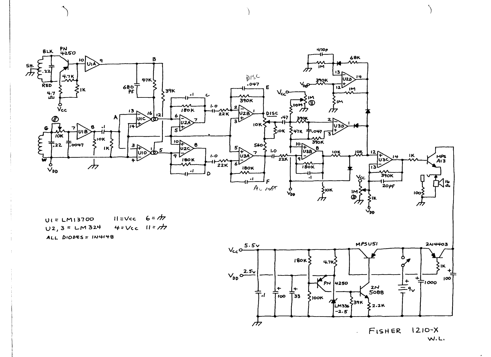

    hi to all,
    i have recently dug out an old 1210x that i used a few years back when detecting with my dad, it was in a bit of a state but after changing the on/off/descrim pot and a bit of general soldering/rewiring shes as good as new. i have tested the macine the last couple of days on some target coins and im not sure its working at optimum performance. i have adjusted the sensitivity pot behind the headphone jack just to the point of no chatter and its prob detecting 3 to 4 inches on a copper penny in air. can anyone tell me what the other two pots do on the board or if there is a sure fire setup procedure to ensure optimum performance?
    thanks
    james.

    I've got one of those! :good
    The schematic is attached below:
    From left-to-right the pots are ground balance, discrimination, disc bias and audio threshold.

          You can set up the ground balance using a small ferrite slug. Set it to reject the ferrite.
          Audio threshold is easy. Just set to almost silent background.
          The DISC bias sets how hard the detector tries to discriminate.
          The DISC pot is on the front panel, and I expect you know how to use that.

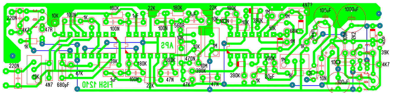

              Hello Qiaozhi,
              You have a Fisher 1210 ? I made a pcb from it... never made it in real so there can be errors in it !. I had in mind to make it for the grandchilderen to use it as a light wight detector on salt sand beach, it must go (long) on one 9v batt..?
              Is it worth making it you think ??
              Best regards.
              Ap

                I think it would be good to make one for the grandchildren. It is very light, unlike the later Fisher models, and only uses 1x9V battery. It has the same type of discrimination as the old Rimatron and Viking detectors, which is not so good. But should be ok for the kids. It has a fixed discrimination setting internally (the Disc Bias), and the Disc control really only controls how hard it tries to discriminate. I modified mine to discriminate against iron on the minimum Disc setting. However, I doubt it would be much use in wet sand, and they would have to stay in the dry areas.

                      Hello Friends,
                      Thanks for the info, ...start making one I think, see how it works. (if ..it works )
                      Hello Ivica, for coils I think that the 1260 family coils work ? some 4.1 kHz?
