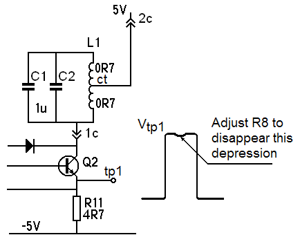

        Funfinder, the change of TX current creates eddy currents in target. The change of eddy currents induces signal in RX coil.
        No need of high voltages. Note that AIR & GND signal in input of RX preamp is a useless relative high voltage which forces us to reduce its gain.
        We have too high TX voltage at pulse induction metal detectors. It saturates the preamp when we use monocoil. We need induction balanced RX coil to suppress this voltage.
        The AIR & GND signal is only milivolts, but it is high voltage relative to TGT signal, which is microvolts. You have in input of RX a useless voltage which is tausend times more strong than target signal.
        The attached diagram is part of TX circuit with center taped TX coil. Such coil increases voltage of tank circuit only twice, but increases battery current 4 times. The AIR & GND signal increases twice and you should reduce the gain of preamp twice to avoid its saturation.
