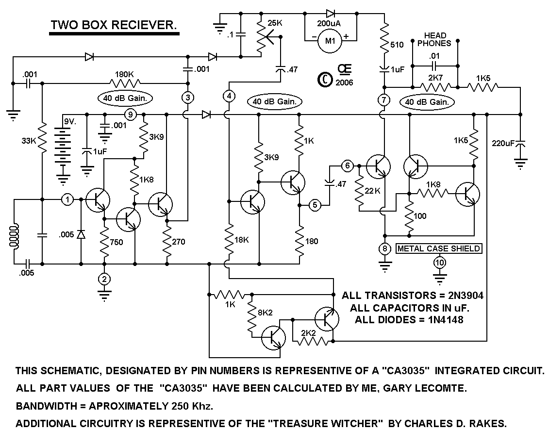

CA3035 substitute.
    Sorry I searched All my Files.

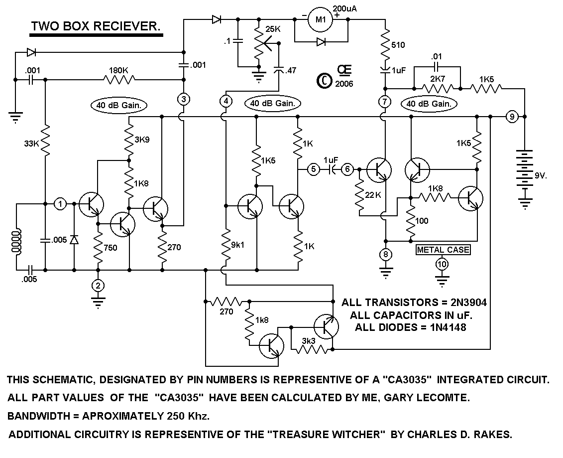

    I still have the Basic Schematic and my original PCB Artwork, but I can't find My Schematic showing the Part Values.
    It must have been on one of my older computers that Crashed.
    I usually keep Assembled PCB's Samples of most things I design, But I also can't find that one their.
    UPDATE: I Just Found the Schematic, where I Posted it on Geotech years ago.
    GO HERE:

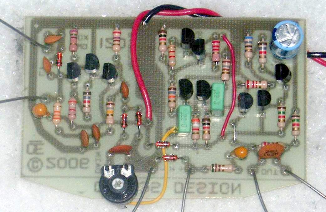

      Here is a Picture of the Assembled PCB and the Schematic.
        I'm trying to make the receiver, do you test it?, and it have the gain of C3035 designe?
          I Designed, Built and Tested this Circuit.
          It appears to work as good as the Original CA3055, But I Do Not have a CA3055 to do more Conclusive Testing and Comparisons on it.
