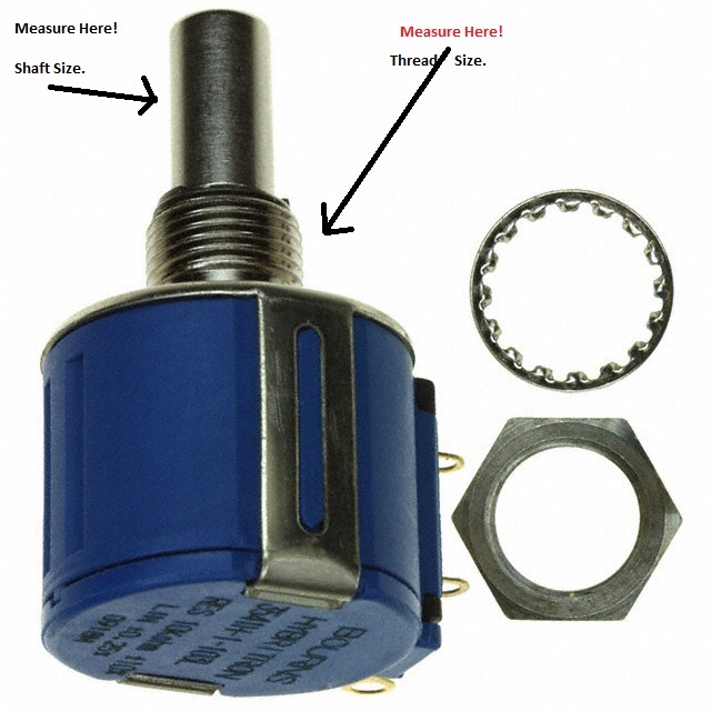

    I'm trying to choose the right Hexeal sealing nut for a new project but I'm lost. I need to know wich partnumber fits my standard 16mm potentiometers (by standard i mean IE the pots used in the Minelab Sovereign XS)
    http://www.alphapotentiometers.net/html/16mm_pot_1.html
    I don't know if I must choose the 1/4 3/8...
    Any help would be appreciated !!!
    Thanks in advance.
    Take a nob off and measure the old one!
      Measure here:
        First, you can't use a Hexseal on a gnurled shaft. Second, most 16mm pots have a 7mm metric collar, and APM doesn't make any metric Hexseals.
