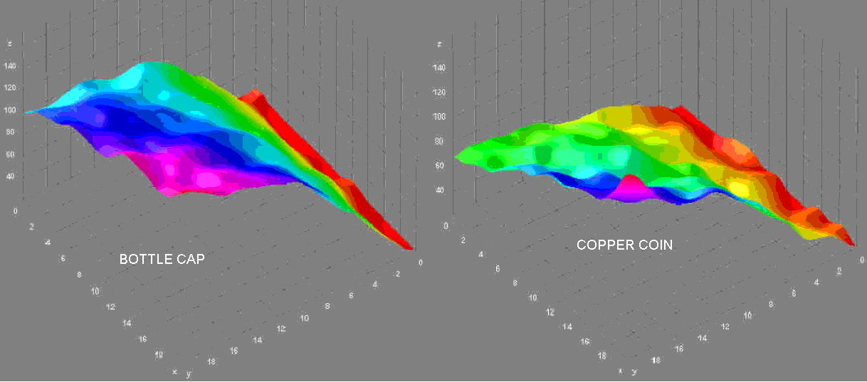

    Yes, 3d plotting
    Yes, tablets (or android phones) are a good interface..
    I have been plotting 3d plots using free software (that will run on a tablet pc)... I posted it on another topic, but my link doesn't work, so I will try again...
    I used 'ImageJ' to make the graphs.
    Regarding the interface between the tablets and the electronics...I have been using USB,..but bluetooth modules will be more elegant. and just as easy.
    The software to develop on Android (Eclipse IDE with ADK (android development Kit) is free...everything is free .

          Hello Tec, very interesting your experiment with android, can you give us more info on the electronic interface (what module you use? )between the input usb of the tablet and your PI because i want to begin some test also.
          Alexis.
            Hello Tec, I can not understand in what part of the plot appears the difference between ferrous and nonferrous target. Is your bottle cap ferrous?
            Please make experiments with separate TX and RX coils placed in induction balance.
              Hi Mike,
              No... there is no obvious difference between the Fe and non Fe on these charts THe bottle Cap is just like a small coin...it has a quicker response. The Copper coin gets stronger with longer sample delay and longer Pulse as you probably know.
              I expect there may be some difference in Fe at much longer sample delay maybe.
              Yes I should do induction balance.
              But here is the thing.. why do people use mono coils ?, i.e the latest minelab detectors sometimes can use mono coils... there must be an advantage.
              And if Fe discrimination is possible,..why are there '5 levels of Fe discrimination' on top-of- the-range detectors, and they still can't manage to achieve reliable discrimination.
              I am under the impression that mono coil gives the best depth....
              I don't want to loose depth...
