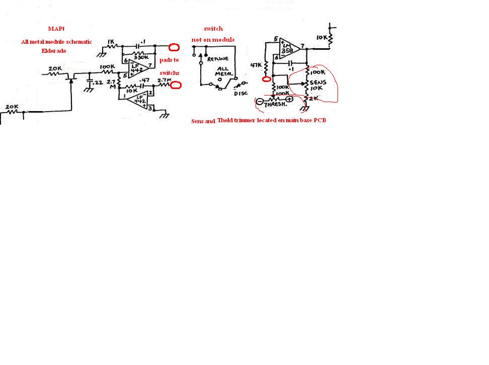

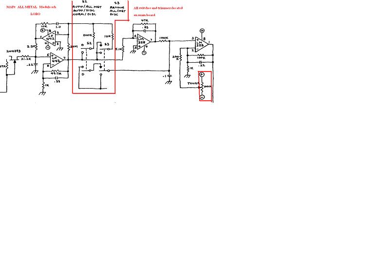

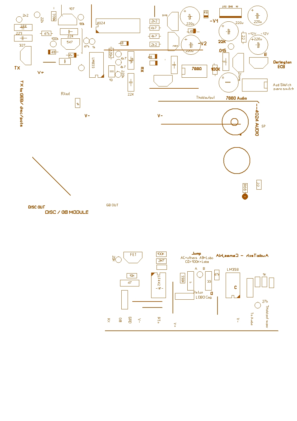

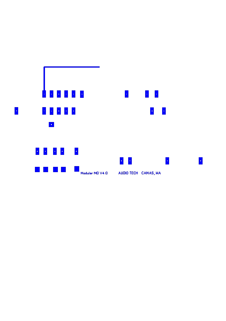

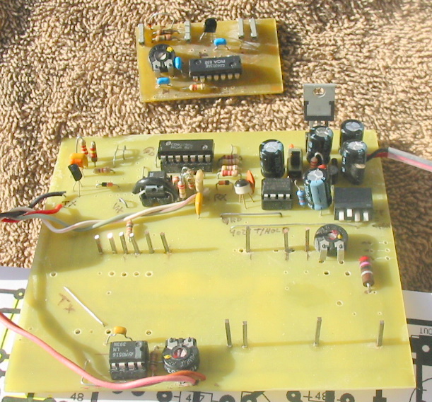

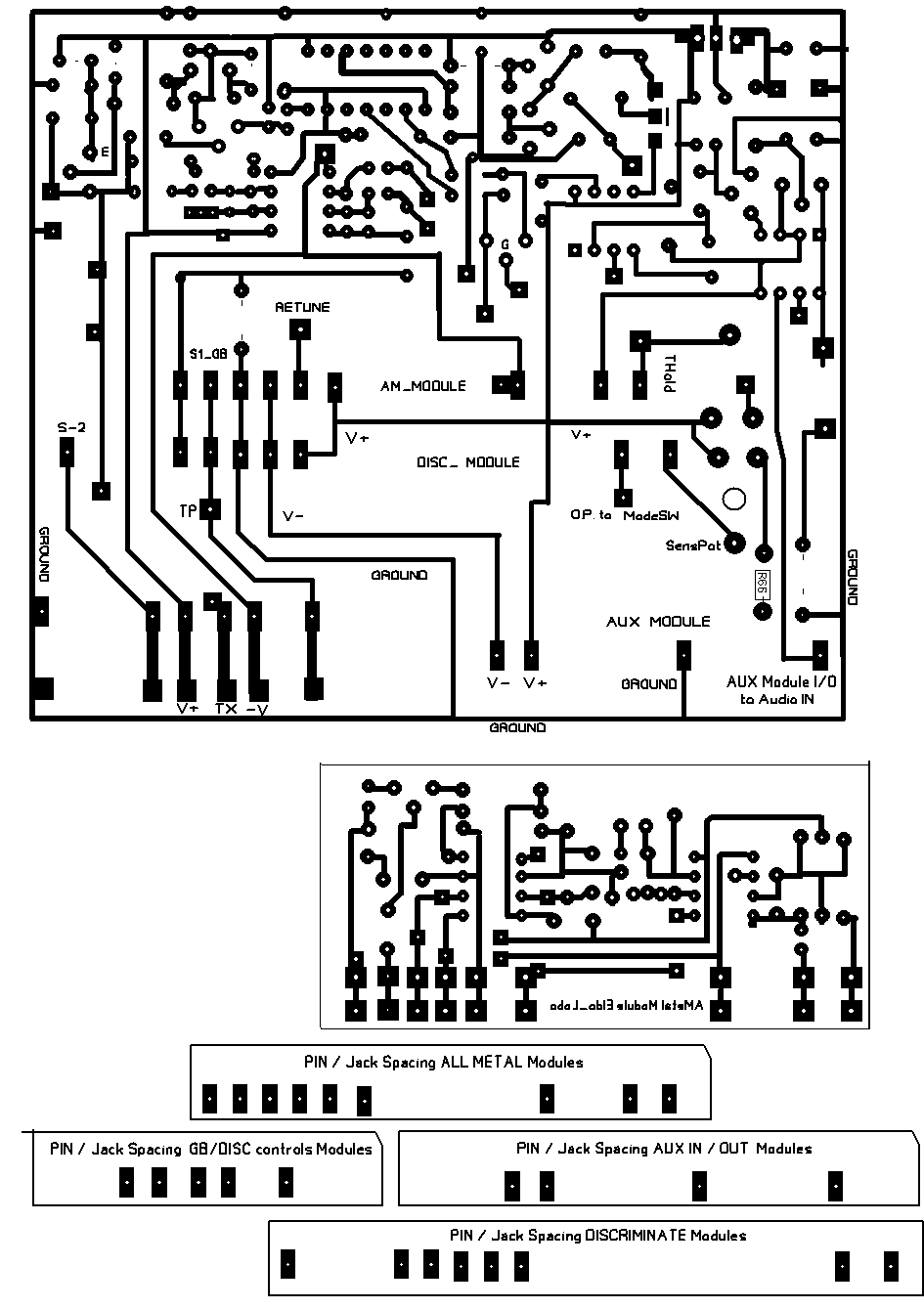

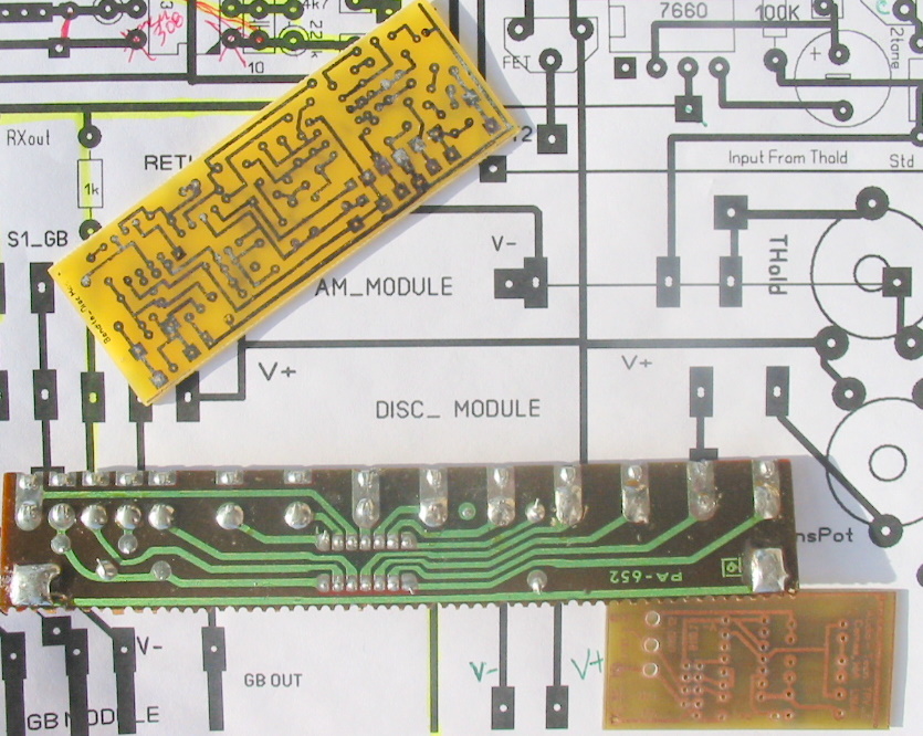

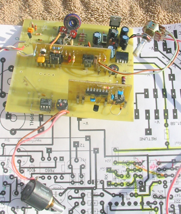

I spent a long while, a good month or more, building a modular Tesoro. All PCBs were created using Spring 5.0. There is a base circuit and 6-8 modules.
The project was started for several reasons.
1. Ability to quickly test the different filters, disc and GB phase timers against a standard to get a better comparison without the question of how much the component manufacturing tolerances of the TX, RX, and regulated supplys components were affecting the results.
2. Quickly mix and match various Tesoro bits and pieces for experimenting.
3. Possible development of a modular analog machine.
4. Ability to try / tie in new circuits or breadboard via an auxiliary port
5. Easily test higher/lower fixed V regulators
6. Develop or use single or double audio outputs
The Tesoro was perfect to fit the idea because all Tesoro models are virtually the same with the exception of differentiators, timers, and added channels for notching. So it is possible to convert a Silver Saber to an Eldorado or Golden saber etc. by simply plug and play.
This worked well for me as I no longer needed to rebuild the same old circuits time and time again to learn about them or experiment on them.
These modules and base circuit were made nearly a year ago and I have since moved on to different interests.

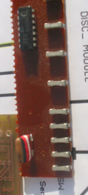

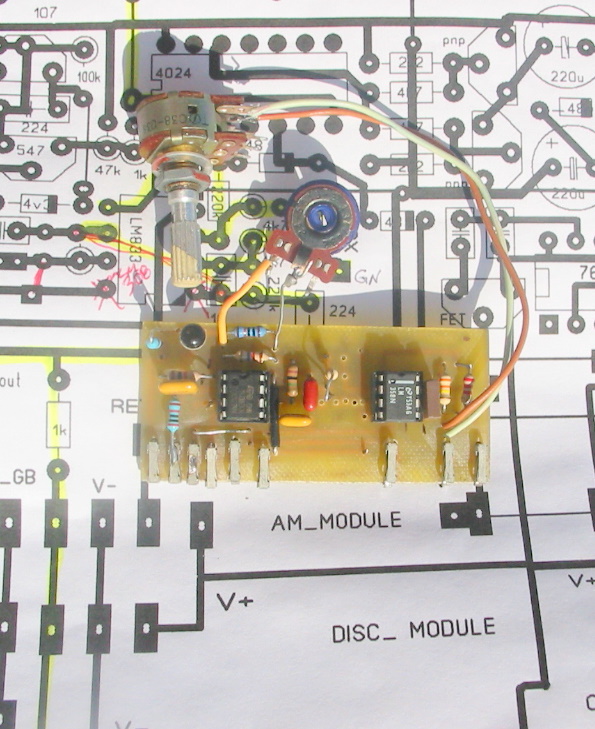

Is there any interest here in developing this project further? It would take a bit of work and time for me to gather my materials, take pix and create schematics of my module boards but If there is enough interest in something like this I will upload the PCB files and take some pictures of my boards. Modules include Eldorado / lobo front end, threshold and audio generator , Eldorado All Metal differentiators, Bandito Disc differentiators, , MPSA13 audio, MPSA13 x2 audio, stereo, mono, and a few others. Base unit has several plug ins for various modules and selectable Neg voltage supply between 4024 and 7760.
I do not have a great deal of extra time to help on the thread here. If there was enough interest ,,,I can see the whole thing crash without someone to help folks trying to build the circuits and answer questions. Is there someone here who has the interest and time to take on and steer this project?
