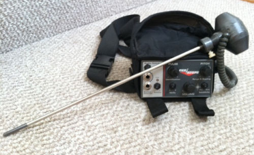

    Any one have a clue how this coil would be made?

        This unit was made by James Ott. He put a lot of time, money and effort into the finished product. Well engineered the probe tip was diamond I believe. It was pulse induction and had a special ferrite core inductor with the ends ground to 45 degree angles. This allowed the user to rotate the probe to give an indication of direction "Periscope". It had some ferrous/ non ferrous discrimination. Don't know how effective? Unfortunately he passed away a few years after it hit the market. see attached patent for details.
          The detector is nothing special really , I was just wondering how the Prob was able to be Directional.
          Ends of Ferrite cut to Angle. LOL Simple and Good Idea.
