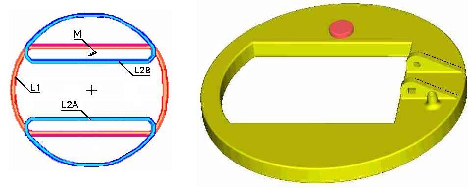

        John, to cope with mineralisation, you need two RX coils placed in TWIN LOOP configuration. You should build DOD search head instead DD. This is valid for both type (pulse induction and sine induction) machines. The DOD configuration can suppress the AIR&GND signal in input of preamp. Then you can increase its gain near to saturation of output. Using DOD, the Eagle Spectrum will operate as an excellent prospecting machine with target VDI, if you can adjust resonance frequencies of TX and RX tank circuits to their original values.
        Prospecting with DOD needs practice because each target generates a succession of positive and negative pulse and the zero between them is used for pinpointing.

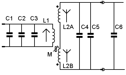

            Hello Mikebg,I noticed in another post that the eagle spectrum coil has some passive components in the search head.
            Would I have to add these in on the DOD coil?
            Also what function is "M".
            I do not not know what inductancies the Tx and Rx coils are.
            Any help would be appreciated.
            John

              John, yes, you should add capacitances iside search head. As shown below, the capacitor C6 for RX tank circuit is placed in control box. C1, C2 and C3 are MKP type.
              M is a ferrite core (or a small nail) placed excentric inside the red knob. The operator can adjust fine induction balance by rotating the red knob.
