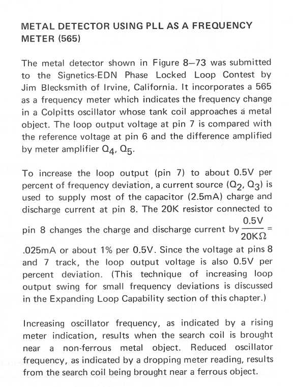

          Here is the text that accompanies the PLL circuit that I posted from the Signetics Applications Manual.

            Re: PLL Detector
            What would be a good choice for Q2,Q3,Q4 andQ5?

              Thanks for posting this. Someone tossed out my old Signetics data books years ago. They had some really neat chips back then.

                hi! it looks that pin 3 go somewhere.the
                info from national semi (lm565)also pin 5
                go to pin 4 and coil.the data looks like pin
                3 go to 1k to 10k hooked to grd.I do not
                try it else.good luck!
                  Re: PLL Detector
                  Try playing with pin 9 of the 565, leave it idle or better connect it to +V with about 100 kOhm.
                  Maybe the coil will not detect many things but you will see on your scope a nice 2 to 3kHz sawtooh at pin 9 and a rectangular at pin 2.
