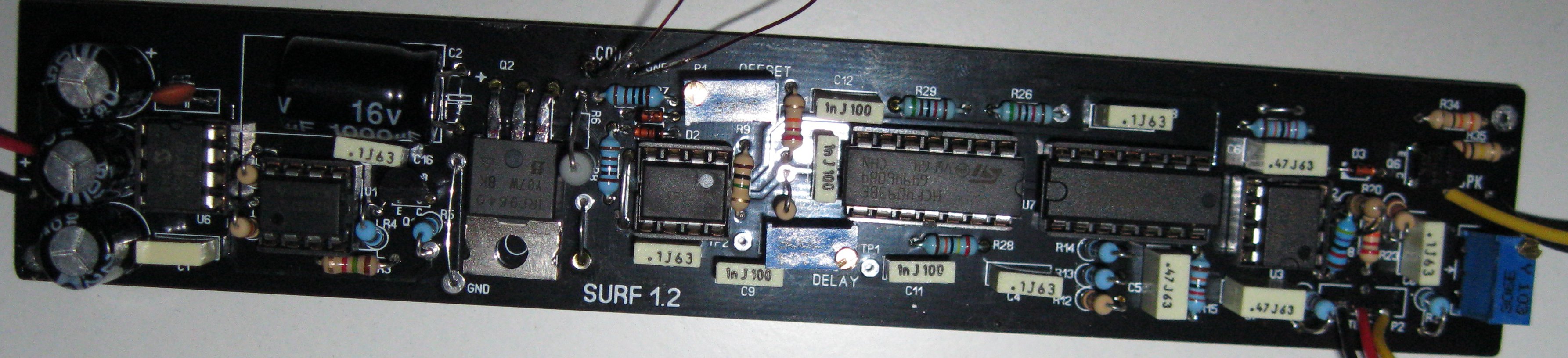

    Hi i have just finished getting my Surf pi together with a home made 23 turn coil made out of some 28awg enamlled wire.
    I plugged on the battery and nothing, well not quite true, if the speaker gets close enough to the coil i get a slight hum. I imagine that means that pulses are being created in the coil.
    Is there anything i need to do after soldering everthing up to get a working detector? Do i need to adjust the pots or do they simply tune the device?

    Gone over all the component placement and cant find anything wrong. Soldering looks fine underneath.
    Regarding my homemade coil, its got a resistance of about 2.8 ohms does that sounds about right? Waiting on an ebay LCR meter so cant test inductance but i cant see it would be way off after using the calculator on the site.

                    Actually i am also going to post some pics and if anyone can spot anything obviously wrong I would very very grateful.
                      pcb
                      here it is acually i think i might be better to take photos tomorrow. cant get the ligh righ and too much flash glare
                        you have
                        C13
                        C15
                        The wrong way round + - / - +
                        steve
                          What GN said, fix them then check your + and - voltages

                            Looking at your photo, it looks like you followed the Old Visual Aid.
                            Check R18 and R22.
                            R18 is 47K
                            R22 is 100K
                            The old Visual Aid had them Reversed.
                              God I feel an idiot about the caps, shows it has been a while since I swung the soldering iron in anger.
                              I am confused about the resistors, I have already changed them to what I read.
