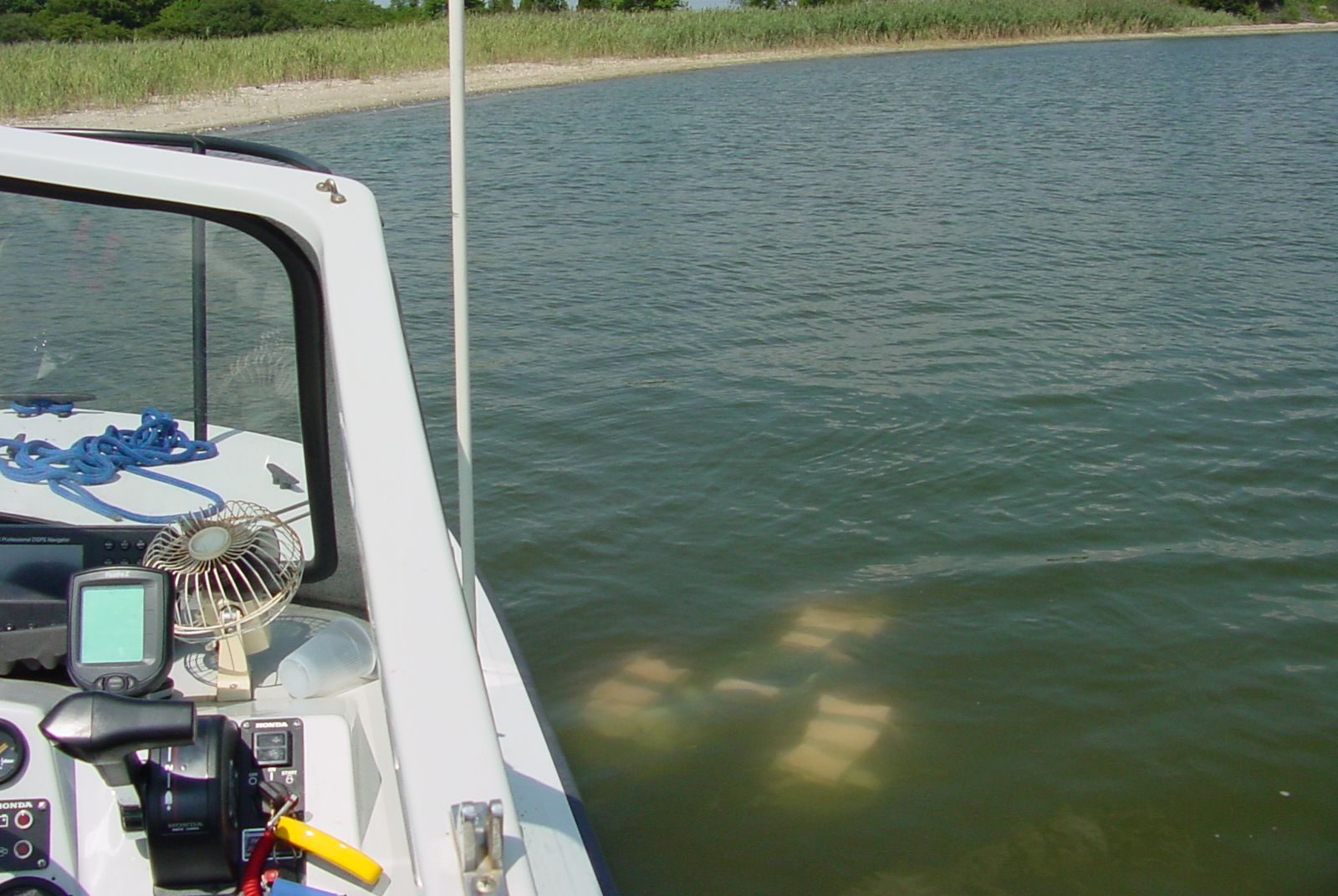

      Anyone considered a submersible, semi-autonomous rover with a metal detector an sampling mechanism attached? I figure that there's probably a lot of loot 50ft off shore in about 20ft of water.
      Something like this:
      http://www.instructables.com/id/Semi...underwater-re/
      or
      http://blog.makezine.com/2006/03/18/...utonomous-sub/
      or
      http://www.instructables.com/id/Underwater-ROV/
      or generally:
      http://www.homebuiltrovs.com/
