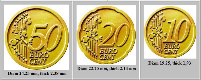

            Dave, aluminium bottle caps can generate signal as silver rings and as some coins.
            The frequency response of a target depends not only of metal conductivity. In reality a metal detector can discriminate targets if they have different timeconstants (cutoff frequencies). The timeconstant is proportional to metal conductivity, but it depends on thickness and square of eddy diameter.
            For example, we have different in size coins made of the same metal. Euro cents shown below are made of brass alloy (89% copper, 5% aluminium and 1% zinc). A metal detector can discriminate them because they have different cutoff frequencies. It is not correct to say that metal detector can discriminate a metal.
            Anoter example are targets made of different metals, but with equal timeconstants because have different dimensions. Aluminium pull tabs have the same spectrum as gold rings. Unfortunately aluminium bottle caps generate signal as silver rings and some very valuable coins.
