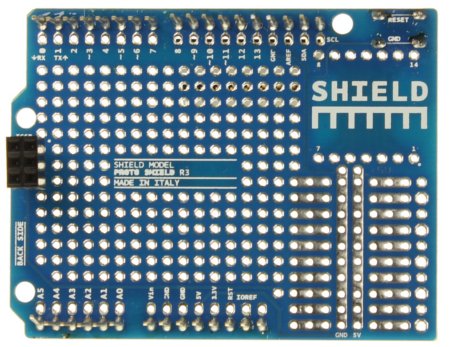

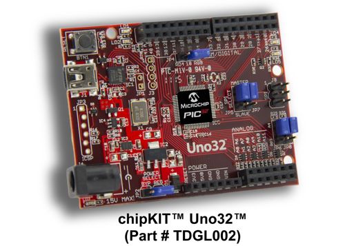

              Its a good pick Davor but more for Linux hackers .... you would have to add some more hardware to get good pulse generation etc.
              I would suggest the UNO32 for example and the protosheild boards for development .... it is 32 bit, runs at 80Mhz, on board programming, has stacks of IO and a high level SDK and best of all its available, open source hardware and software, standard arduino interface and is around the $25 mark. There are stacks of ther modules that can be stacked ( no pun intended ) on top.
              moodz

                  [ATTACH]18751[/ATTACH]
                  [ATTACH]18752[/ATTACH]

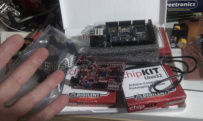

                        LOL .... oh so thats what that stuff littering my workbench is ... thanks Mario ..I was going to throw it out.
                        Moodzarduino
                          Seriously though ... if you read my orginal post carefully ... I never said to use the arduino SDK .... I meant use the Microchip IDE MPLAB .... Get yourself a good book on C .... look at the sample code on the microchip site ( theres heaps ).
                          The arduino SDK uses psuedo C or "sketches" .. it would be an OK platform if you could see the C code generated before it compiles. The trouble with sketches is they hide alot of the meaningful info with regard to real time programming which you will not notice as a biginner but will regret when you become more experienced.
                          The microchip pic32 ...absolutely creams the Atmega parts ( about 40 times faster ) used on the original arduino. When you are trying to get some 32 bit numbers multiplied before the next pulse arrives on your PI circuit ... the Atmega will not cut the mustard.
                          Mario, your advice is OK if you never want to get past blinking LEDs, reading some slow speed ADC or start stopping a motor but if you want to perform a realtime FFT in 24 bit math you will need the Microchip part ( and guess what ... there are prebuilt libraries to do all that DSP stuff ... you dont have to code it )
