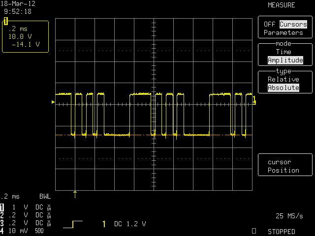

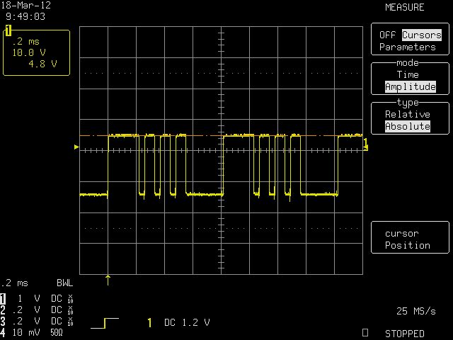

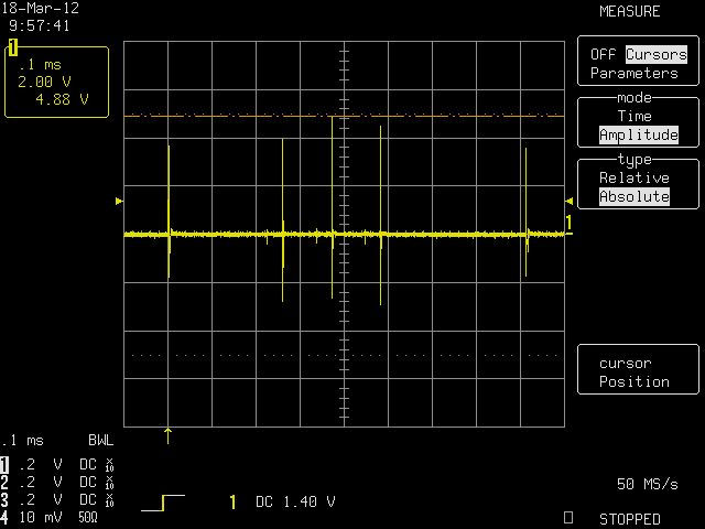

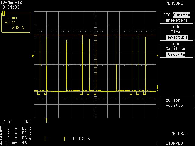

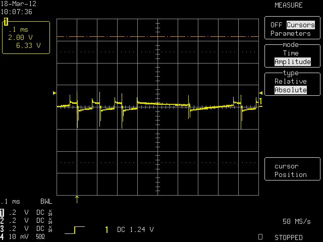

                            Ok, turned it on this morning and hey AUDIO. Cool!
                            I took some scope photos. Gates of the 2 fets are driven without the small transistor, so it has some other function. I show pins 1 and 3, pin 2 is -14.2V.
                            Favorable(?) signals on the left fet, peaks to 208V.
                            On the right fet, I don't know... maybe ok maybe not.

                            Leftfet drain
                            Rightfet drain
                            Rightfet source (same as left one)
                            small trans left pin
                            small trans right pin, middle -14.2V
                              Look at that, there's that famous Minelab signal train!
                              I'm surprised you are detecting a flyback of 208 Volts. The RX N Fet maybe rated at 230Volts? Either that, or there's something wrong with your circuit, frying your fets. The ones in the 2100s/2000s are rated at 200V. Also, the stock flyback on my 2100s was around 184Volts.
                              Hey Mick, is that a frequency of 1.25Khz? I maybe wrong, wasn't the 2100s around 1.4khz? or is my math wrong
                                Ok sounds like the other half of this circuit is damaged with bad P channel fets, diodes, and maybe whatever drives them. So I will have to scratch off more paint and do some component testing. I'll order parts mentioned just in case.
