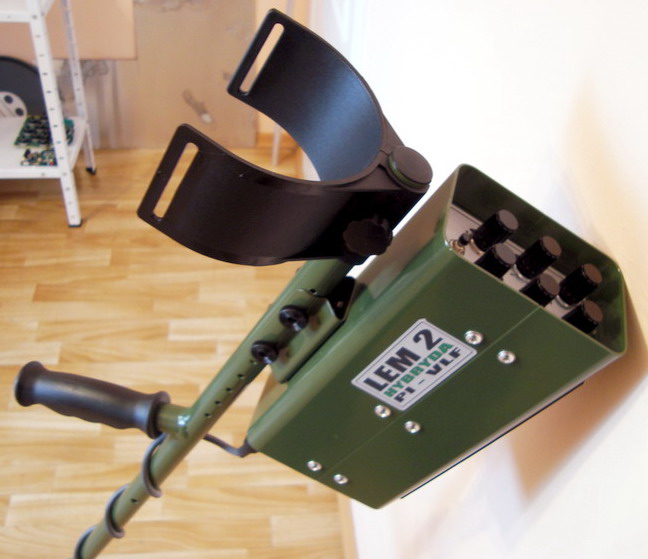

              The hybrid detector exists already for a long time. Systems PI and VLFwork simultaneously and are complementary to one another. At present I can't write more because the patent application progresses.
              Mrand
                Nice looking machine you got there!
                Happen to be multifrequency vlf?
                I need to buy/make myself one of these machines for beach hunting...

                    The combination of fields is not so easy - must provide tangible benefits. Two detectors in one box is not a method .. I do not even know if it is worth. They benefit from the study of signals, different in the time domain and in the time frequency. You have to really desire and experience to combine these two different poles.
