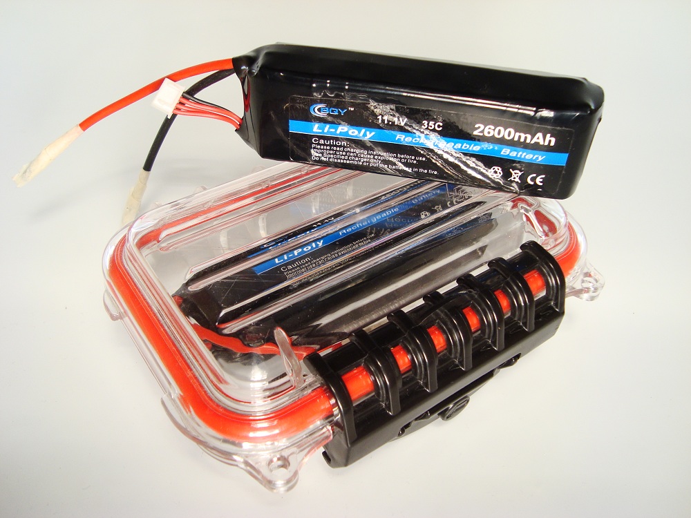

                          I should have mentioned I meant a LiPo pack used in hobbies, like the one pictured here. It only has one connection, separate from the "power" lines.
                            Either way, whatever works, have fun.
                            Hi UFO, where do you connect than 4 wire connector, to some chip I suppose?
                            Regards Marko.
                              The pack on a photo looks promising. So how exactly do you charge it, and by what name do I search for it.
                              I know that LiPos are a bit tricky.
