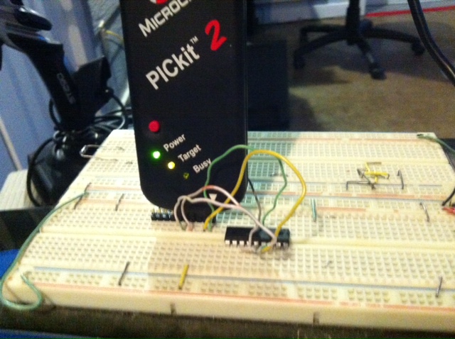

          My VDI kit from Siverdog would not work right. The PIC controller just kept locking up. I finally ordered two new 16F88's and figured out how to program with a PICKIT 2. No more lock-ups now. I did a verify to compare the .hex file from this site with what was in the chip and if failed. I then re-programmed the original chip, but haven't tested it yet. I'm just glad to have my VDI working finally.

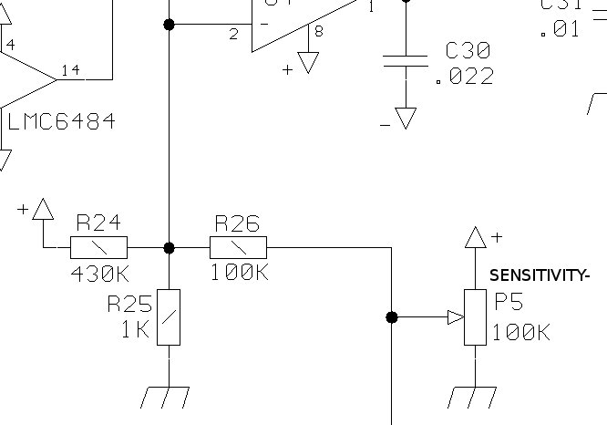

            Here is my solution to the Sensitivity adjustment problem. This is taken from the original Classic 1/2/3 schematic. This gives me an adjustment range that seems normal.
            Merc

                After getting a Max 800 coil I finally got my IDX Pro kit to work pretty well. I also changed the 47 ohm resistor to a 1k and the sense adustment seems to work like it should. Now to get a homemade coil to work worth a darn heeh. I have a new appreciation for coils.

                        To gain depth in the IDX-PRO, there are two things you must consider.
                        1. The U3, which is the LF347
                        2. U4, which is the LM393.
                        I to get the depth I wanted, I had to try more than 20 such integrated circuits. You have to try many, because what happens is that each of them, the detector operates in a different way. The R25 has to be a multi-turn potentiometer varying 1K. The potentiometer sensitivity, P5, has to be a 100K potentiometer to have more room for regulation of sensitivity. I think that's all. No more secrets. The potentiometer of the phase, the VR3 must be at least, I mean it does not exist, as pointed. The threshold, must be regulated so that when the button is pushed PIN-POINT, listen to the speaker a slight buzz.

                          Yea, the big thing I found with the LF347 is that there is very little offset, so it allows you to set the DISC mode sensitivity - P5 (or threshold actually) very close to the offset of the LF347. Problem I am working through is now mechanical stability, even with a stock 950 coil. Tons of adjustment range!!!
