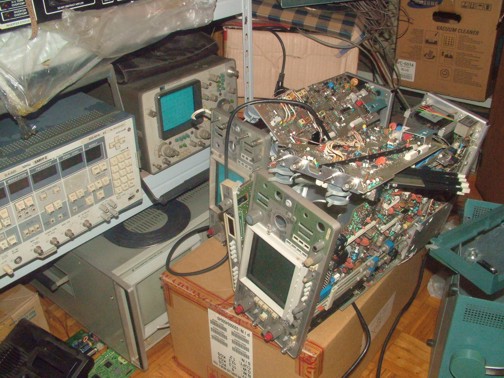

              Something like this. (OK, bit more maintanance is needed here).

                      Bandwidth itself is not that critical, 20MHz will do, not only for MD but for most general electronics, even 10MHz will. (I keep 20MHz BW limit turned on almost all the time on my scope). Problem is, 10-20MHz service grade scopes are cheap but usually crappy, whit lower CRT display quality, lack of features and poorly built. Somewhat older lab grade instrument in similar price range, or somewhat higher, is better option for me. Additional performance may be useful in some situations, extended BW, dual timebase etc but if you can utilize 100MHz BW most of the time, you need 350MHz scope already. (My friend just hit one 4x350MHz Tek on Australian Ebay, in perfect condition for 399AU$, but this is really not needed for any hobby electronics, some cheap DSO can be far more useful) Question is, as always, what is the budget?
                      Anyway, even worst scope on Earth is about zillion times better than none, without it everything is only guesswork. Only whit proper bench scope in place, consider anything portable, USB, pocket etc.
