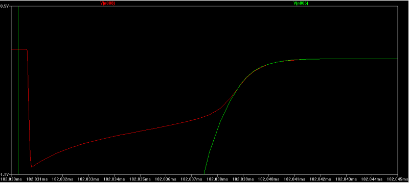

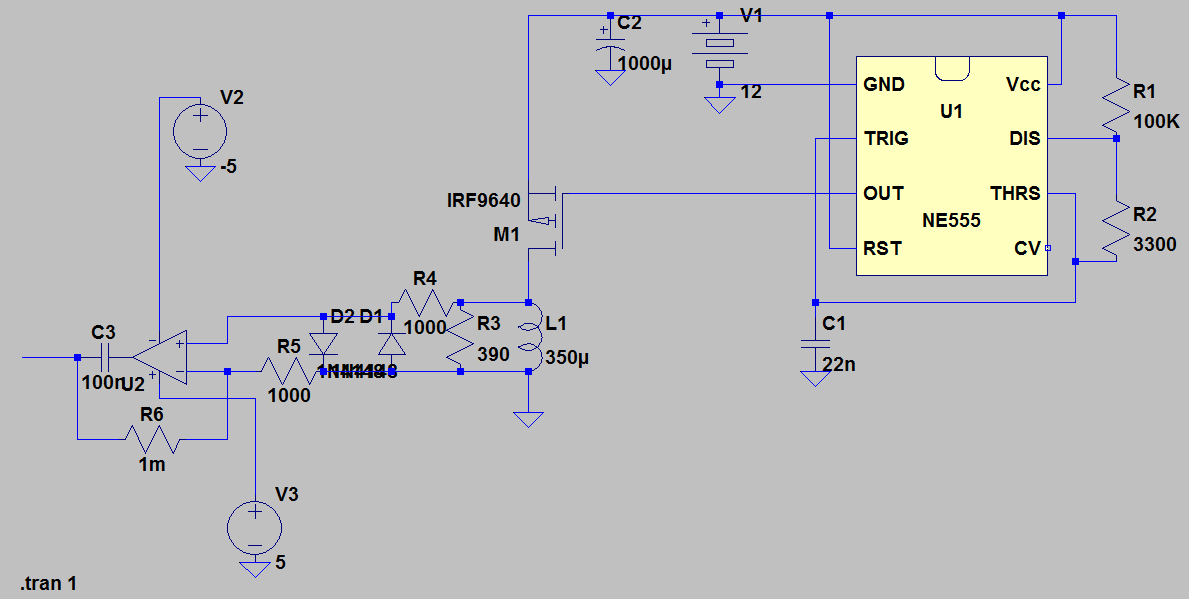

    I am currently in the process of building a Surf PI Pro and waiting on a few components to show up from eBay so in the mean time I decided to run a simulation to see what is going on in the Rx section. A lot of you will recognize the front end schematic (hopefully I have drawn it correctly). So to help us noobs out I am looking for confirmation of the simulation oscilloscope trace. It is a zoomed in version of the decay curve. The green is the raw curve which spikes to -400V taken on the top connection of the coil (after mosfet). The red is output from opamp.
    Is this what the real thing looks like or something like it?
    From what I can tell it is in 1uS increments. Could someone please point out where a first sample would usually take place and perhaps for how long?

    The Rx decay would be much more meaningful if some target is simulated as well, so just connect a coil and a resistor in parallel and one side to the ground so that LTspice does not complain. For values see some topics with simulations. Then just give your target some coupling with PI coil and you are there. Alternatively you may .step param resistance in a target to see what happens with different metals.

      Here you go. It's the LTSpice .asc and the others. Not sure what you mean by coupling (1pF capacitor?)
      Really just looking for an idea of what a proper decay curve should look like after it's been clamped, so if one were to get experimental in the future they would know they're on the right track... Have seen the hammerhead project but just wanted more references.

        I'll have a look. On the first glance, there is too much time given for the simulation, but it is of no importance here. I'll make some additions and post it here soon.
          Davor -> Thank you. I am getting a grounding of what to expect to see, so if strange things pop up on the real oscilloscope, I can assume something is malfunctioning. LTSpice has a bit of a learning curve but is an awesome program!
            So there are a few minor mistakes, and one that must have caused lots of confusion: 1m = 1 miliohm but 1meg = 1 megaohm. You must be extra careful with gain here because it is directly related to the delay of feasible samples.
            Try the corrected circuit
