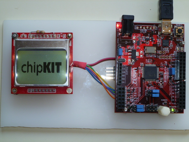

    well to start it off, here's a picture of my Chipkit uno32 with the nokia 5110 display attached
    if you noticed, I ran my wires to the bottom of the board, that way it frees up the top of the board. also the 4 pins coming out of the side are for power. more room for experments.

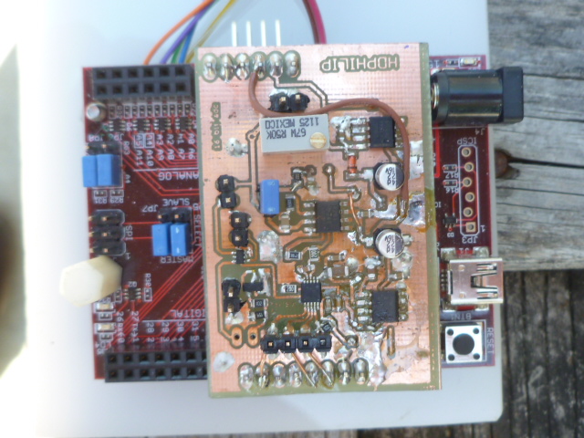

            well here's my first hardware experiment for my chipkit uno32, it's based on the ADS8319
            16 bit analog to digital converter.
            500 khz sampling rate
            Conversion time 1.4 us
            Acquisition time 600 ns

                Are your sampling directly from after preamp or amplifying more again? Any noise problems, yet?
                I haven't really put any thought into that, one of the curiosities i have is what kind of sample rate i can achieve using MPIDE.
                As far a noise goes, so far it seem pretty good, been thing about stepping up to a 24 bit ADC chip
                On my test board you see a number of IC's I'll be posting the schematic soon, basically I'm feeding the ads8319 chip using a THS4281 buffer, and a ref5040 for the voltage reference.
                I also put a 7660 as a voltage multiplier to take the 3.3volts to about 5 volts, that didn't work out as well as i planed, so i ran a jumper to the +5 volts, it powers the voltage reference and the op amp and the analog voltage feeding the adc chip,
                The gray trimmer is used for testing it's just a 50k pot between the +5 and ground. i did put a 1 uf cap on the bottom of the board between gnd and the wiper the clean up the test voltage.
                The lower left i included a n-channel moset, the input isn't hooked up yet, the idea being if everything works out i could use it to drive another circuit for a coil.
                Above the mosfet, you can see a little 6 pin chip, that's a audio switch DG4157, I got that idea from forum member jon-ecm's project . here's the idea, it's a 1 ohm spdt analog switch, one side of the switch would go to the preamp/coil, and the other side of the switch goes to ground,
                it just a way to use software to control the input, and i am curious to see it work, with it's 1 ohm rating, it may be better than the commonly used 4066's
                all of the 2 pin jumpers are for testing.
