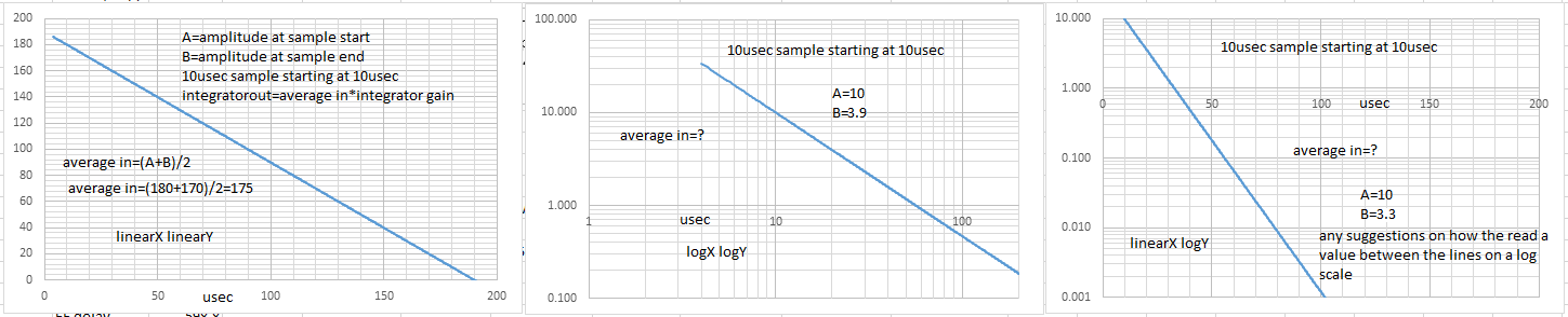

      Integrator out=integrator gain*average input signal during sample. Think I know how to calculate average signal for a straight line decay on a linear X linear Y chart. Is there a formula for calculating average in for straight line decay on linear X log Y and log X log Y charts?
      Integrator out opposite polarity average signal in. First example should be -175
